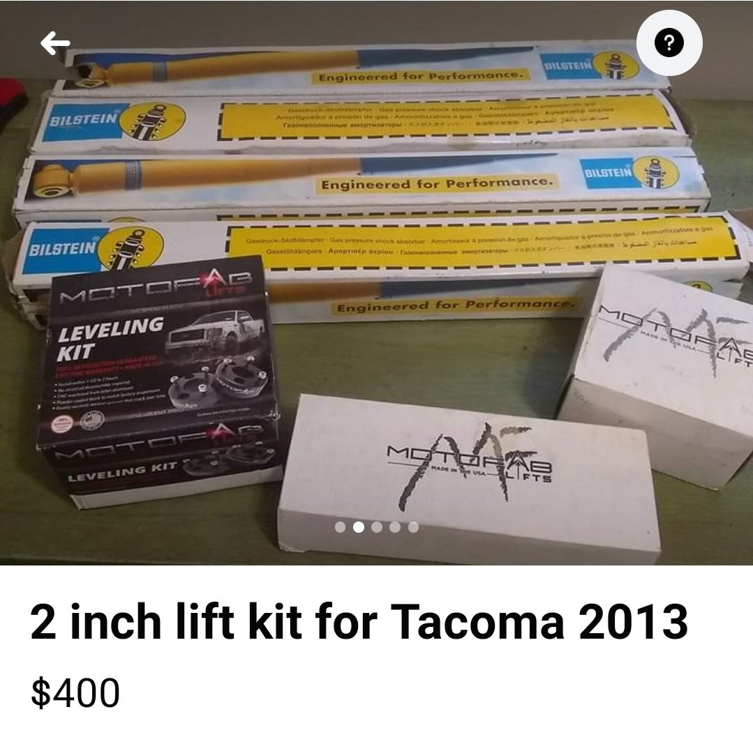

    I saw this on Facebook market for $400, if it's the same 5100 lift everyone else talks about, it's a killer deal.
    Have a 2019, thoughts?

    Yes, Third Gen and Second Gen suspension is nearly identical.
    Hence the reason why many companies say 06+ when it comes to basic Tacoma suspension.

    Based on this link, I don’t think so...

    I agree with you on the deal. Many places are also running Black Friday deals.

    Thank you for the responses! I won't buy this, thank all for the education
