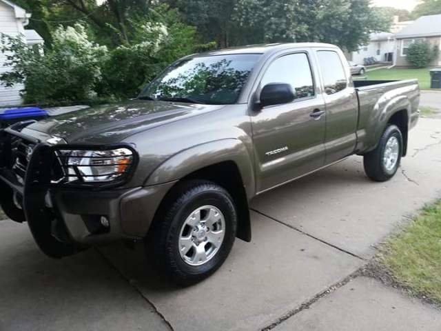

    Hey! This place looks pretty knowledgeable so I figured I'd stop by and check with the experts before I spent some $$$. I've been a gear head for most of my life, and mostly dealing with mustangs. Among others in the stable, is an '03 Mach 1, and an '87 LX 5.0 that I race in the NASA Central region.
    What brings me here today is one of my brothers, who's not proficient with tools at all, wants me to modify his 2013 Tacoma, extended cab 4x4 for him. He mostly does mall crawling so I convinced him not to do anything crazy. Knowing him, and interpreting what he's telling me, he's looking for 2.5-3" of lift, stock driving feel, and no issues with U/CV joints. I tried to do my research before hand and come up with a good combination. So far I've come up with:
    http://toyteclifts.3dcartstores.com/OME-Tacoma-Suspension-lift-kit_p_231.html
    885 springs, no spacers, and no stone guards
    He would like these wheels
    http://www.autoanything.com/wheels-rims/american-racing-atx-series-ax185-crawl-wheels
    I selected 17x8's, 6 x 5.5" bolt pattern, with no offset
    and for tires
    http://www.tirerack.com/tires/tires...hite Letters&partnum=87TR7DESTATOWL&tab=Sizes
    285/70-R17
    I'm just wanting to double check with you guys that this combination will not cause any issues. I've heard mixed reports that the front tires will contact the upper control arms or fender liners when you turn sharply. I wouldn't have an issue if it was my vehicle, but I know he's going to get real nervous if I crawl under there with an angle grinder or sawzall. However, most of those reports have been with guys still running stock wheels so I was unsure if that issue when away with the 0mm offset of the aftermarket wheels or not. Also, the OME lift seems to have a positive report on this forum, but just to double check, this will not cause any other drive line issues, correct?
    Thanks for your time guys.
    Edit: Results are on page 2!

    By extended cab do you mean the access cab? If so you will definitely want to get some UCA's. The 885 springs on an access cab give more lift than they would on a double cab so your stock UCA's will be more than maxed out.
    Best to get them on while your front end is already taken apart.

    Great advice, thanks! Yeah, he really doesn't go off road much at all. I'm pretty sure I can convince him to let me do minor trimming. I just know he'll shit a brick if I pull out half the fender liner. haha
    No diff drop, and look into carrier bearing shim kit. Got it.
    He wants different wheels, that's why we're switching to 17's. Will 265s look alright on a 17 inch wheel? I know there's only 20mm difference between a 285 and a 265 but sometimes it's the little things that bring a look together.
    Apologies for my ignorance, but I have no idea what you said here.
    I'm not very familiar with the sub models. You tell me.
    Hey, that's a plus!
    I could turn this into a fun prank. :cool:
    Hmmm... well drive line vibrations will not do. He won't be okay with that, nor will he know what to do.Do you have any links to the axle shims? I've already had one for the carrier bearing posted.
    Thanks for all the responses guys. I really appreciate it.

    Excellent post! Now I've got a plan B in place if things don't go well. Does anyone think I should switch to the 884 coils? I thought we needed to go with the 885's since he had a cattle guard on front. Nice looking truck too.

    I didn't know his truck had a heavy bumper on the front. Since that's the case then definetly go with 885's. Some people say 886's but unless he's gonna put on a winch those would be too stiff.

    Double cab with front plate bumper; could always go with 887 coils.

    Wow, thanks for the explanation! It sounds like you just pieced together what the OME kit offers though. Why did you go that route?
    Yeah, it's just a brush guard. Not a complete bumper replacement.
