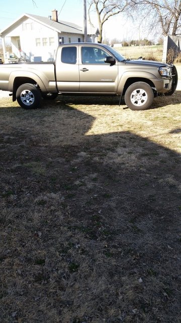

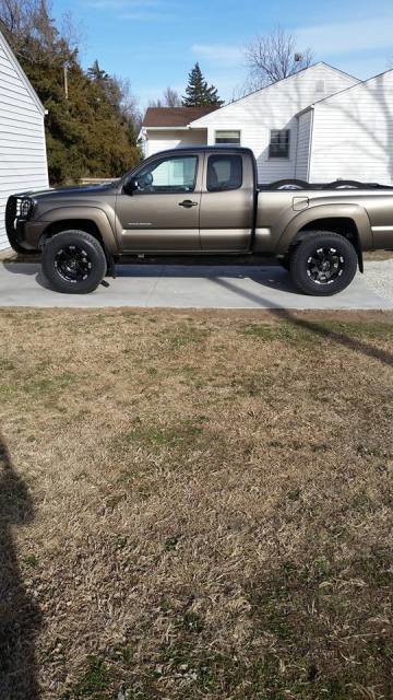

    Well we installed everything yesterday and it was a good time. We spent a little over two hours installing the first coil and strut on the passenger side; had to figure out how it all came apart. However, once I learned all the tricks, we had the drivers side changed out in less than thirty minutes. Another hour and a half for the rear. Then we had to drive into town to get new lug nuts since the rims he selected wouldn't accommodate the stock nuts.
    He was extremely happy with the both the looks, and the ride. He said he could tell it was a little stiffer, but still felt great. We only had to remove the front mud flaps from the front wheel wells. The tires barely kiss the rear mudflaps when turning, but neither one of us believed it to be a big enough deal to mess with, plus we were running low on beer. No vibrations were noticed either. Final combination was the Headstrong lift kit with OME 885 springs and Billstien 5100 shocks, American Racing ATX Crawl Wheels in 17", and 285/70-R17 Firestone Destination AT tires, though we did get them in the P version instead of the LT so I believe that minutely helped out with smoothing out the ride.
    I really appreciate all the help this forum has provided for me. Not only was I able to save him about $700 from what I started out with, I learned a lot in the process and was able to go into this with a lot of confidence even though I haven't messed with Toyota's before. Thanks again and enjoy the before and after pics!
    EDIT: Alignment was completed yesterday and all is back within spec! No upper control arms needed. Still no vibrations either so no wedges or spaces required as well! Thanks again.
