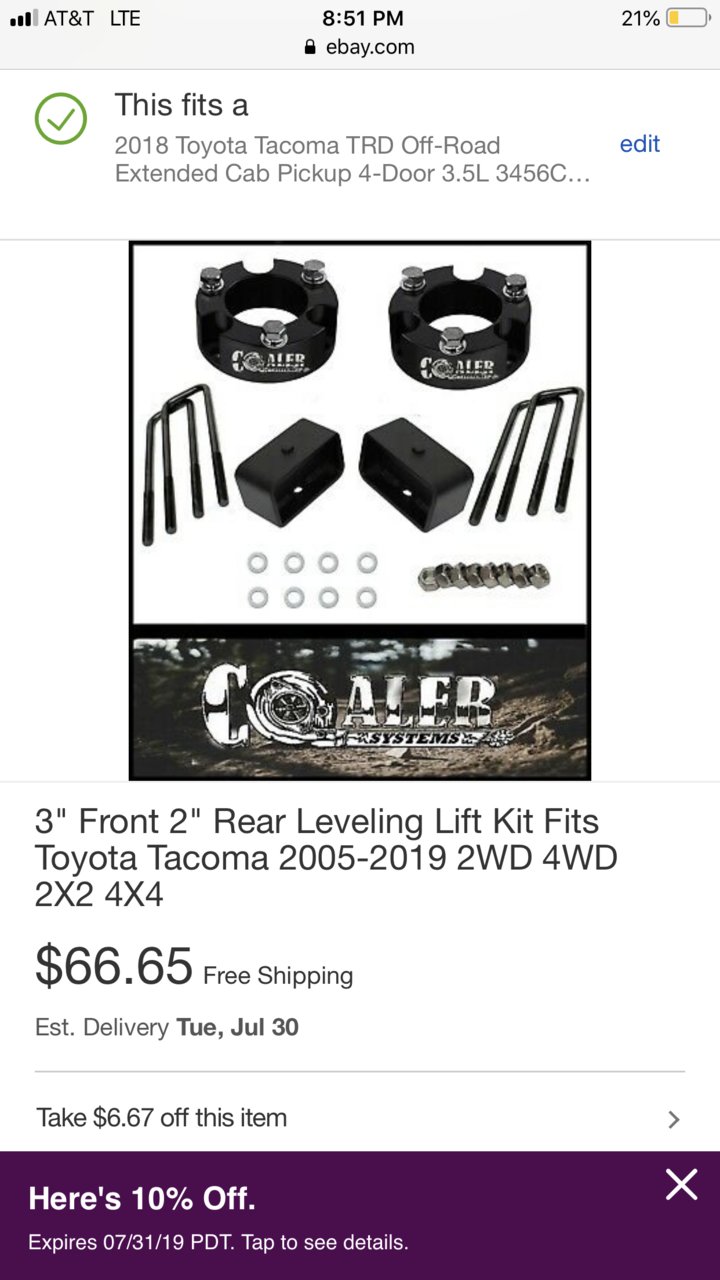

Will this fit my 18 TRD OR LB

    I dont see why it wouldn't
    If your 4wd it may not be a good idea to 3 inches in the front though

    We’re pavement only lol

    Even so, it may affect the CV joints to bad angles and premature CV boot wear.

    If 2wd, go for as big a lift as you like, spacers or whatever. If 4wd, sticking to about 2.5 is best or if you want bigger like 4 or 6 then you need a drop bracket lift ( cut cross member to let the front diff lower).
    I am not sure if applies to top shock spacers though.

    I found kits with the drop diff and they were 3f 2r spacers. Would that be a better one?

    I am not sure about that. I don't have much knowledge in the spacer category as my truck sees dirt.:D

    Yes, but a cheap lift kit like that will ruin the ride quality on and offroad. Its gonna be a rough ride. Rear won't ruin it, it's the fronts that will. Especially 3 inches up front
