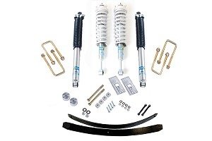

    So I don't consider myself a complete newb, but I definitely don't have enough knowledge to tell if this setup will work without doing my own trial & error. With so much info stickied on lift and suspension, I get lost in it and I confuse myself sometimes...
    So will this setup work? Will I run into any issues? i.e. rubbing (something a minor trim job can fix?), wheel spacers required?, do I get the LR UCA's or not?, etc
    16" TRD Trail Team rims:
    Wrapped in 285 Duratracs:
    And the 3" lift kit with Bilistein 5100 Height Adj. Coilovers, with the CS047R Dakar leaf pack (not pictured) from Toytec
    Thanks

    You'll be good, with 285's you will have to do some minor trimming on your fenders flares. You won't need spacers either. As for ucas you may or may not need after market ones. Some guys can get stock specs and others can't.

    What setting would I have to set the billies at to achieve the max height, but maintain the levelled/stock rake?

    If you don't add any rear lift the front setting will need to be 1.75 if you add an aal you'll have to bump it up to 2.5

    Do adding the Dakars qualify as adding lift? Or no? I know some who would consider those as lift.

    Haha yeah those are lift. Around 3 inches of it actually, you'll want to set the front at 2.5 then. Also look at getting the extended rear 5100 shocks and exteneded rear brake lines as well.

    If ordering from toytec, they should automatically ship with extended 5100's shouldn't they? After all this is the business they're in, or would you have to request them?

    Never mind... It says right on their site they use extended 5100's.... I'm more newb than I thought
