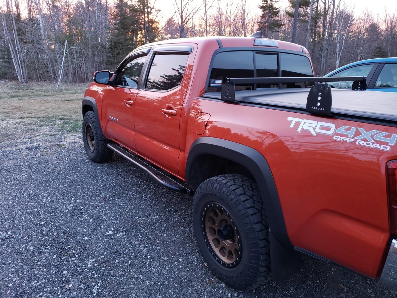

    I run Method racing 17x8.5 0offset no spacers, 265/70/17 31.7" tire and have no issues, but that said with the 0offset its as wide as when i had 1.25" spacers on my stock OR rims.
    this pic is with NO lift...

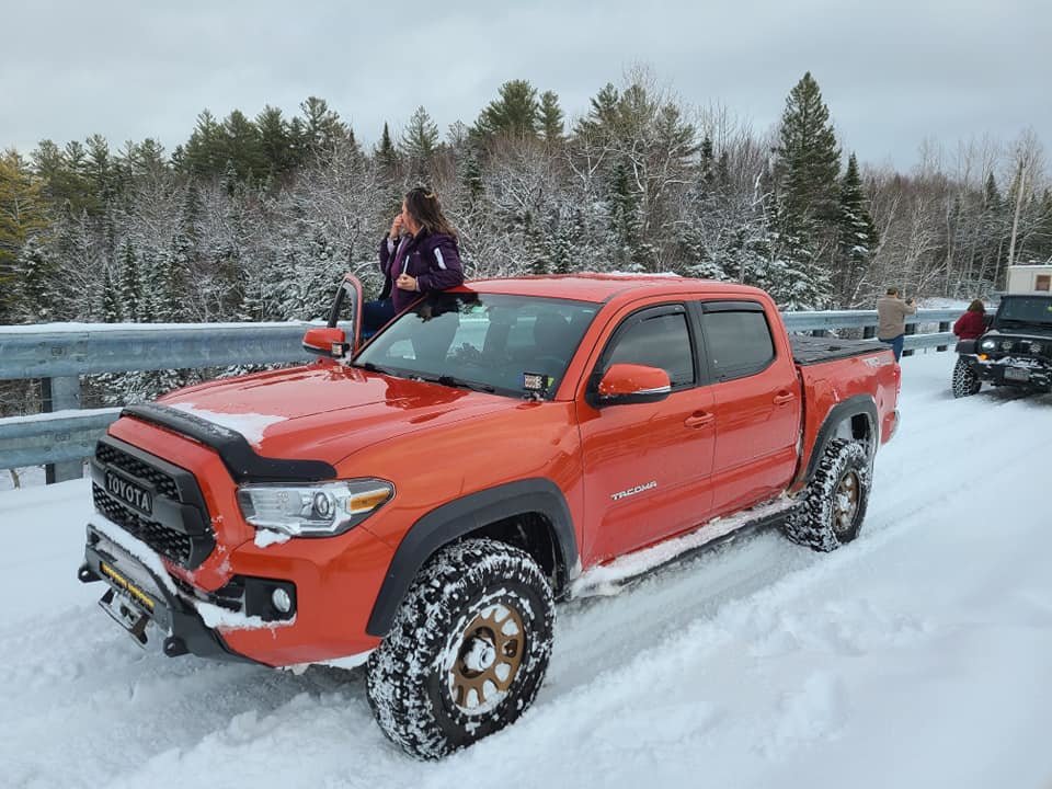

    Lifted 2.4", JBA UCA's, snow wheeling 2021..
