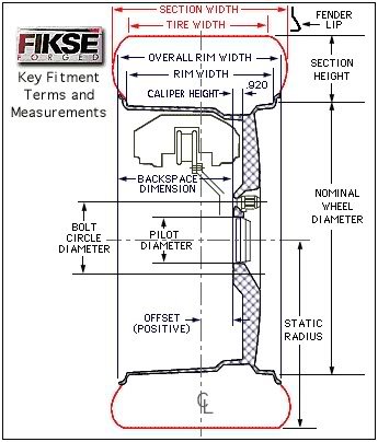

    Because "rim width" is measured as the distance between the bead seats, and backspacing is measured from the back edge of the rim.
    So rim width doesn't take into the account the lip of the rim on the front or back of the rim, and backspacing does.
    Go out an measure the total width of your rims on your truck. They will come out about 1" wider than the advertised "rim width"
  6. Apr 12, 2011 at 9:33 AM
    KPT
    KPT sees what you did there.
    Sep 3, 2009
    #22227
    32,330
    09 Prerunner
    Katskin leather interior, Satoshi grille, Bilstein 5100's @ 1.75, rear leaf TSB, magnaflow exhaust, 18x9 BBS RW's, 275/65/18 Nitto TG's, black headlights, black taillights, Hella Supertones, weathertechs, EFX tri-fold tonneau, n-Fab steps
    Here this picture shows the difference:
    note the rim width is different than the "overall rim width"

    No kidding? I didn't know that. So my tape measured 8.9" wide wheel (widest measurement of the wheel width, i.e., "overall rim width") is really probably a 8.5" or 8" inch wide wheel vs the 9" I though it was? The rims are a set of old school KMC Tarantulas.
  8. Apr 12, 2011 at 10:58 AM
    KPT
    Sep 3, 2009
    #22227
    32,330
    09 Prerunner
    Yep if you measured the overall rim width to be ~9", then the "rim width" per se is more like 8", and that's what the offset get's calculated off of. (But NOT what the backspacing gets calculated off of)
    It's obviously a very confusing way to do it so I'm not sure how/why it got started like that.
