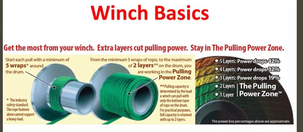

    for the rotational efficiency part, winches are less effective for every wrap on the drum:
    or, on page 2 of harbor freights flagship apex 12,000 pound winch, they specify that with 4 wraps on the drum, the winch's max pull capacity is only 6,732 pounds. a snatch block on that winch would decrease the load by 50% on the winch, but also use more cable, getting further into the wraps, which further reduces the overall load on the winch.
    all that to say, the nilight product is more than fine, and the appropriate use and kitting of your new toy is far more important in the long run.
