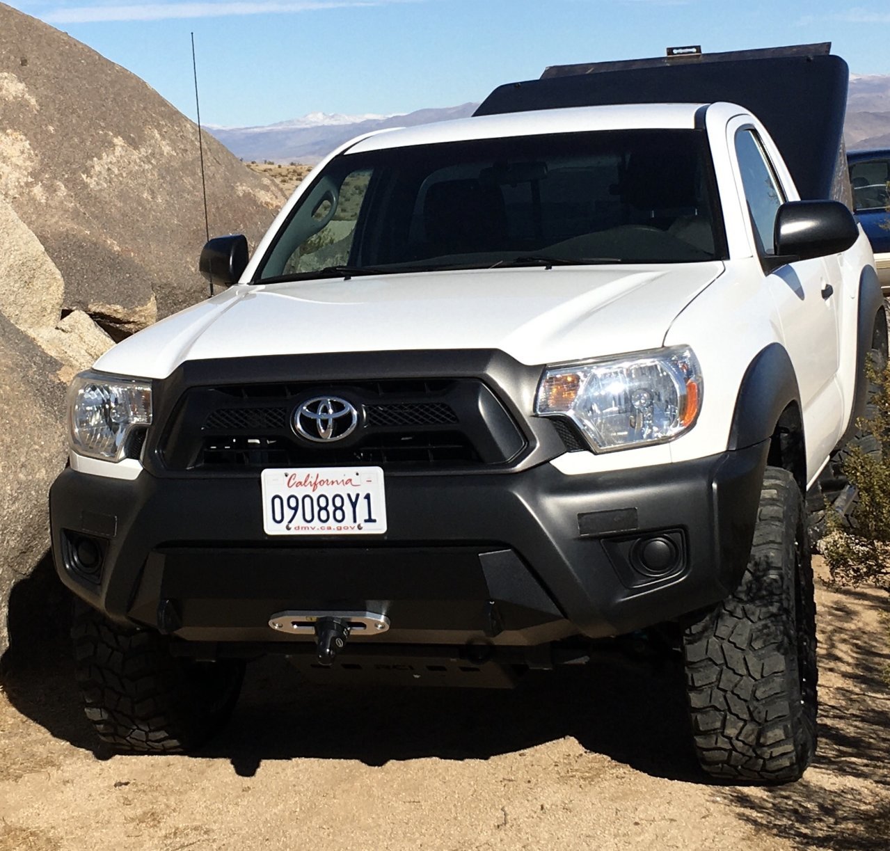

    Hi All,
    I’ve got this SSO Slimline bumper with no access cutouts which make it virtually impossible to see the spool.
    I know I’m not the only one with this setup, so I’d love to know what approach other people take to make sure their cable is respooling correctly.
    As good as this thing looks, I actually bought it to use.

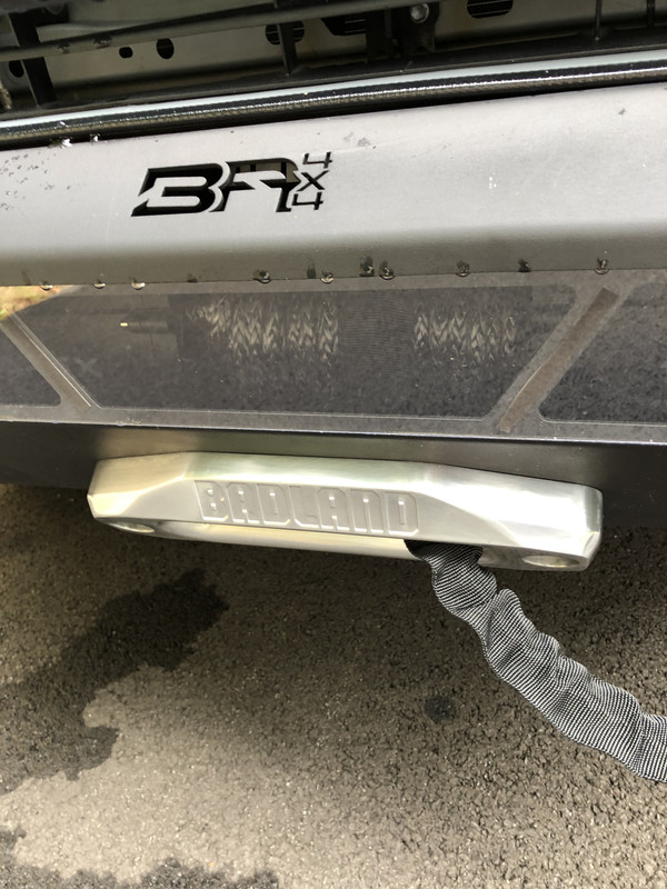

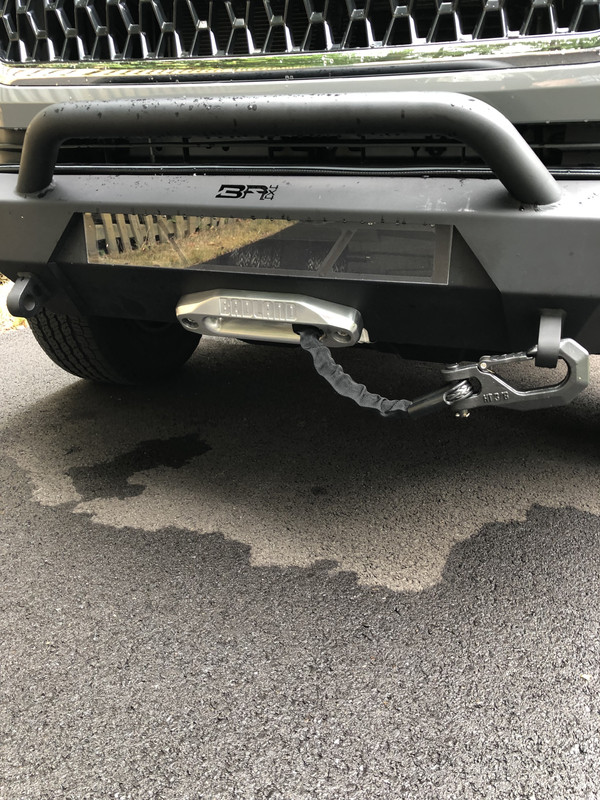

    I installed a Body Armor Hiline bumper not too long ago. Also installed a 22" light bar and a 12K Harbor Freight Apex synthetic line winch. I was not thrilled with the idea of not being able to see my spool though. So I reluctantly removed the lightbar, and affixed a piece of polycarbonate sheeting to the area vacated by the light bar, with double sided 3M tape.
    Now I can see the spool, and the polycarbonate will keep road debris (mainly the brine, salt and other crap that Maryland loves to douse the roads with here) away from the spool and the synthetic line while not in use.
