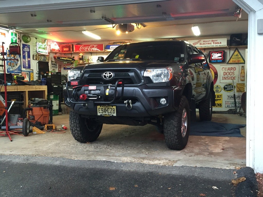

    The MTOR recovery bar is 65 Lb's. Winch with rope 85-90 lbs (heavier with cable), and the cradle mount is 30-ish Lbs.
    My setup is the MTOR recovery bar, and a Comeup 9500 lb winch on a cradle.
    With 886's, I can tell the difference when the winch is on or off. And the front sits a LITTLE lower with the winch on. Only like 1/8-1/4 of an inch. But, that's with 886's. It would be cosiderably worse with softer springs I Would imagine.
    So, it's not a plow by any means. But, still something to cosider when choosing coils. For me, the weight up front is the reason I went with 886's with 1/4" top spacers.
