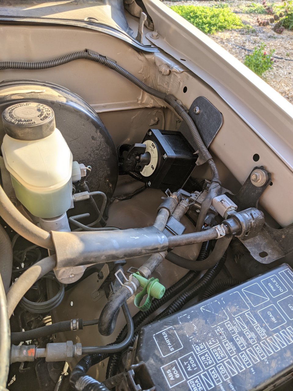

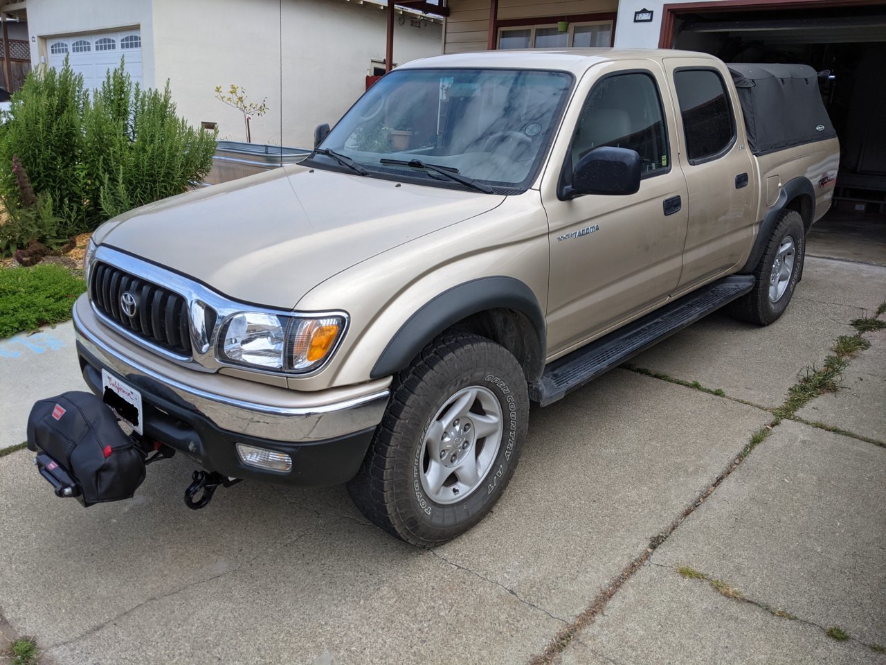

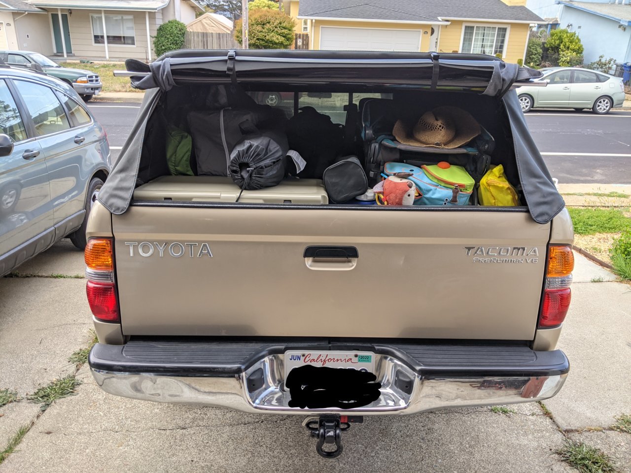

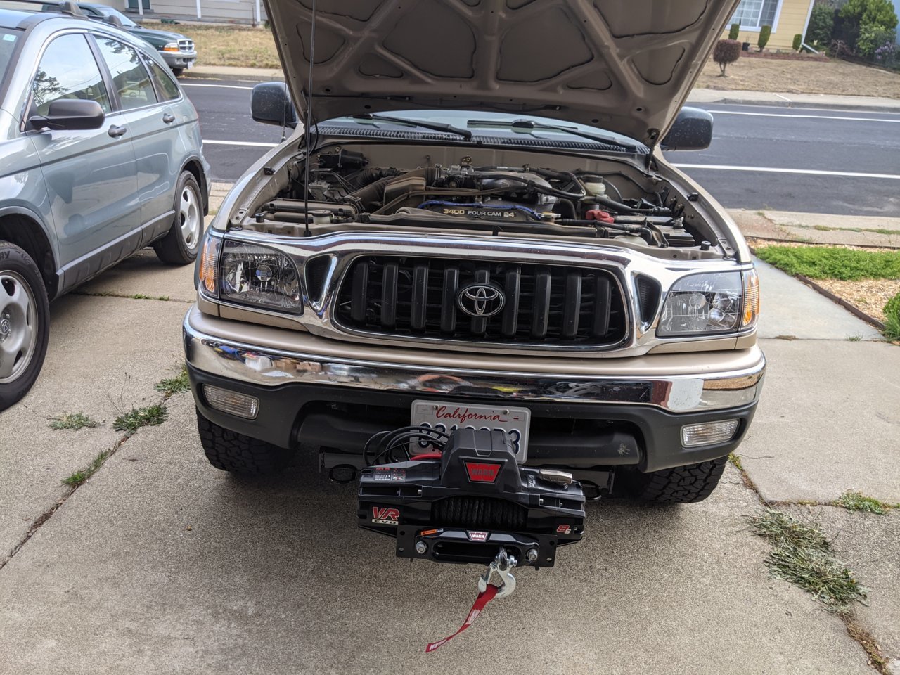

    Ended up getting the vr8s mounted at long last - I had been waiting on the receiver from etrailer forever (6 weeks!)
    I wired the winch leads to an Anderson connector, and ran leads from the battery to an Anderson connector that will live under the front bumper. I used a blue sea locking battery cut off switch (the only option in stock when I ordered) to act as an interrupt when the winch isn't mounted (which will be most of the time). I made a simple mounting plate from a piece of aluminum I had a use for years ago and never threw away, it ended up working out really nicely with minimal effort -painted it with paint I had left over after I modified my DR650's frame.
    Tested the winch, and it works! Didn't load it up, just jogged the line in and out 20 ft or so.
    I also tested the battery cutoff switch, and indeed, no power to my Anderson connector in the off position. I have the leads for the rear, but I haven't yet installed them, but I'll make sure they are installed before the first time I hit the trail, because if I don't, then surely I will end up stuck and needing it ear mounted...I opted to buy the rough country kit to make things easier (plus I got a wicked deal on fourth of July), FYI.
    All in all, I ended up spending a lot more that I wanted to, but I do have more confidence in this equipment, and for something that should be your last resort, that makes a difference in my book.

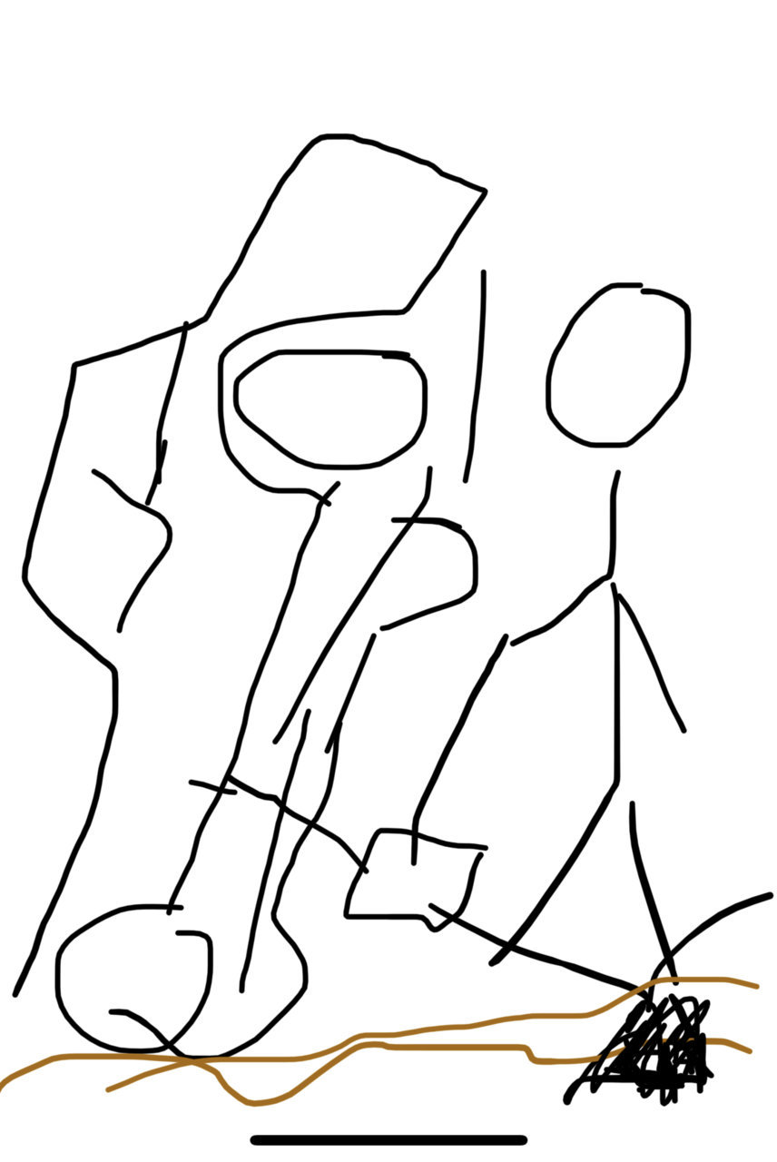

    so you can use this GripHoist to move a vehicle without an anchor?
    Can you do me an MS paint of how that works?

    I wrote that you don’t need a tree or a rock as an anchor, that’s what the pull-pal is for. Or you can dig a trench and bury your spare tire in it sideways.

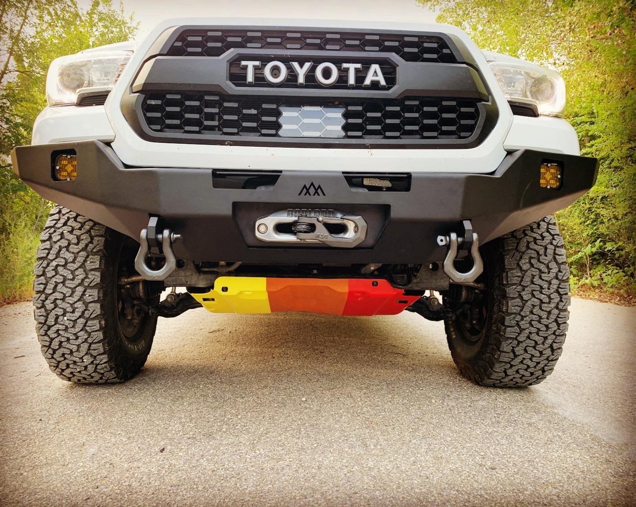

    They also have a badlands apex winches on Both of the XJ Jeeps and the custom corvair wagon. I messaged them about the apex and they said the winches have been working great.
    I couldn’t find a bad review on the Badlands Apex 12k. Just 2 cases where the mounts on the bumper twisted or broke which twisted the winch.
    So I picked an Apex up and it’s been great.
