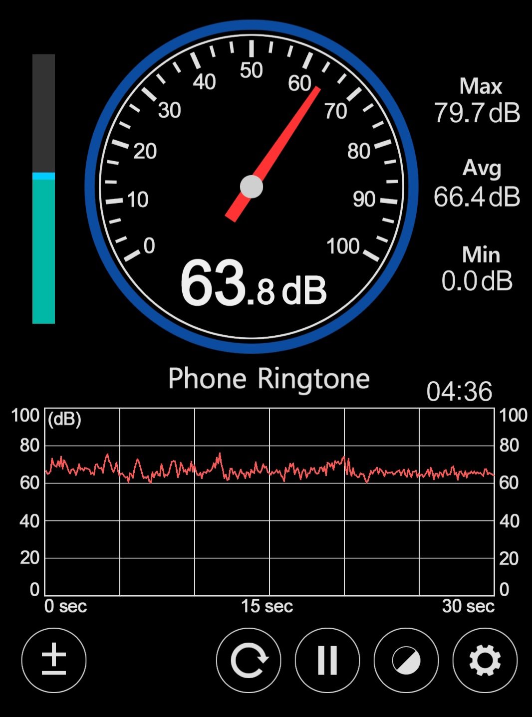

    Maybe 2 decibel difference including adding this mod + pipe insulation outside of the pressure release vents. Decibel meter previously linked is highly sensitive to any noises. These are on the low number side. TIFWIW. :notsure: My "seat of the pants" feeling was about the same (2dB).
    Normal cruising speed before:
    Normal cruising speed after:

    is this A weighted?
    generally, anything less than 3dB difference is imperceptible by the human ear.
    the difference numbers are so small (and conditions so uncontrolled for such small numbers) i think you really can't draw any meaningful conclusions from them. but it appears it may have a measurable desired direction, even if you can't hear it :).
