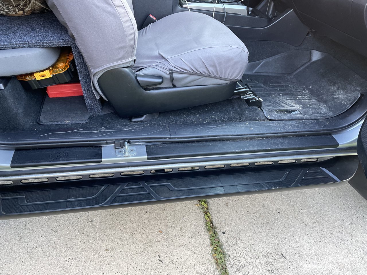

    Put the bottom pieces on today. It made a noticeable difference, but not as much as the upper pieces. My friend rides in my truck a lot and noticed it was quieter without me mentioning I had added the strips. I put it down lower than I think some might, but I didn’t want to add anymore resistance to the door shutting.

    I was just thinking about that on my way into work as I was enjoying the new peace and quiet. I promptly removed the lower gasket because the drain holes do land on it. I don't think there is a way to install it on the lower area without causing this drain issue AND if you install it higher to where it hits the existing strip, the door will likely not shut very easily.
