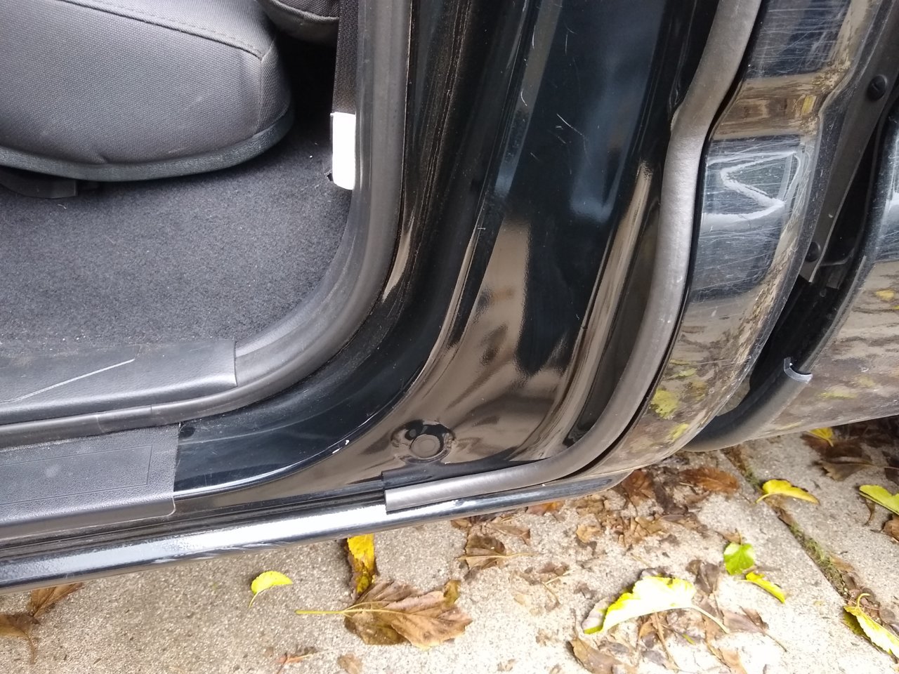

    Where did you guys go down along the rear doors? I notice my rear doors close, but they are not flush anymore and when I put pressure, they move in a little. Fronts seem to be fine though. Haven’t noticed any rattle or wind coming through in the back, but I feel like I may need to move them in a bit to get the doors more flush.

    Thanks OP for this write up!! I finally got around to doing this and extremely helped out from the wind noise. I already dyno matted the interior and doors. I upgraded my speakers and amps.. My goal was to keep the surrond sound inside without the outside noise and hissing from the doors. Music sound much better like a Dolby atmos surrond sound and can hold a conversation without the wind and other noise outside. Pretty much eliminated the hissing sound from the doors.
    FYI.. I ran the rear strip along the outside groove to give me a flush seal but others went in the middle.
    For those who have a sun roof, I had some extras and decided to run the strip along the edge of the trim. I made sure it did not hinder from the sunroof closing and opening operation. That really made a big difference and helped it seal from the wind noise. Hope this helps.

    I went with @Will'sSR5 recommendations and worked like glove. Tight seal and not hard to shut close but requires break in period to mold into place.

    I installed this mod yesterday and I'm not seeing the results you guys are seeing. My cabin was already pretty quiet but that's because I've got 2 layers of noico deadener on all 4 doors. I can't say I noticed the cab being any quieter after doing this, but I don't have a SPL meter. The only thing this mod has achieved is making my doors harder to close. The front ones aren't too bad but the rear ones I have to slam shut, enough to the point that I'm thinking about removing it.

    did you take it out on the interstate? wind noise on the interstate was the biggest improvement for me.
