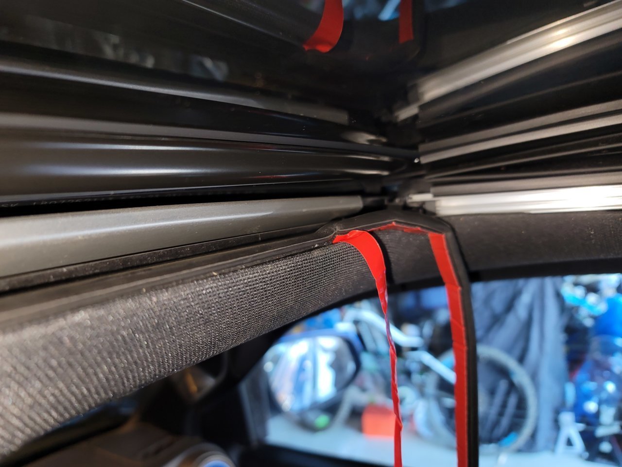

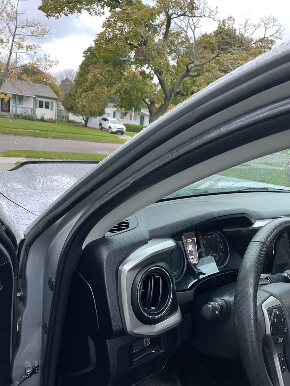

    Please explain or post a zoomed out photo of where this went on the sun roof?

    This was the picture from his post. It looks like (correct me if I'm wrong), it goes on the front of the sunroof. (Not the sides or rear.) Which makes sense, since that is where the wind mainly comes in from:

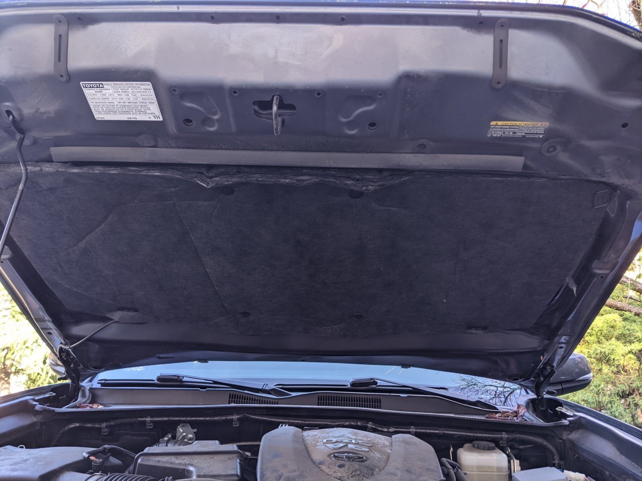

    I don't have before/after numbers. But for folks looking to make their trucks quieter: Two things I did that made a big different:
    I hung 1lb mass-loaded-vinyl on the panel in the back of the cab replacing the factory one. I cut it to exactly fit the shape of the back panel under the rear window. To my ear it cut the amount of in-cab noise by half on the highway on smooth pavement. Even more on rough pavement. I also put in a underhood insulation mat - it significantly cut down on some of the mechanical clatter from the engine but also cut the intake resonance by impressive levels.

    Which hood mat did you use?

    Got any pictures of the under the hood work you did? I've been thinking about doing this the day I bought my truck.

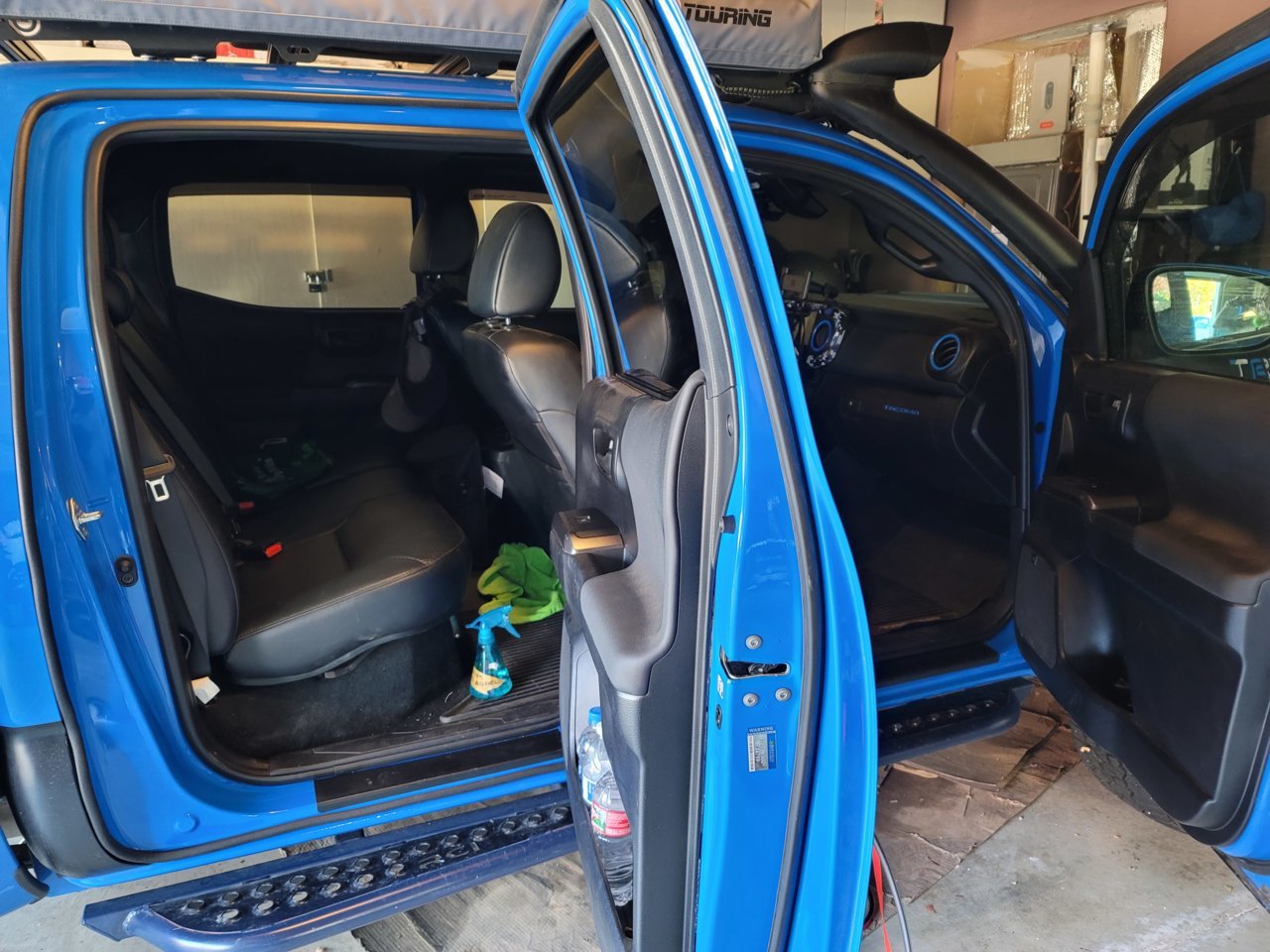

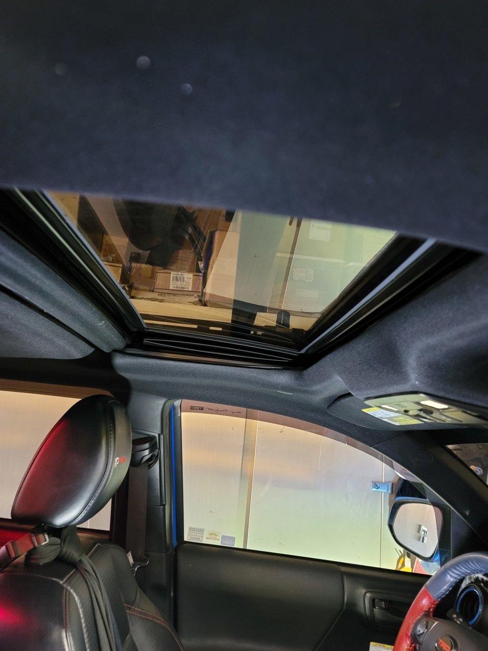

    Here is zoom out pic open and close. You can barely see the rubber trim. And I had enough to wrap around the roof. I placed the trim just on the edge of the panel. I started from the driver side aft and ran it forward. I had two remaining seals from the doors. The 1st piece ended on the passenger rear and used the 2nd remaining trim piece toward the rear and finished from where I started. Take your time on the corner seal, it's doable but a tight reach.
    I have a roof rack with recovery gear case, air intake, and ARB awning passenger side on the roof rack. IMO it made a difference giving me a better seal in that area. Hope this helps.
