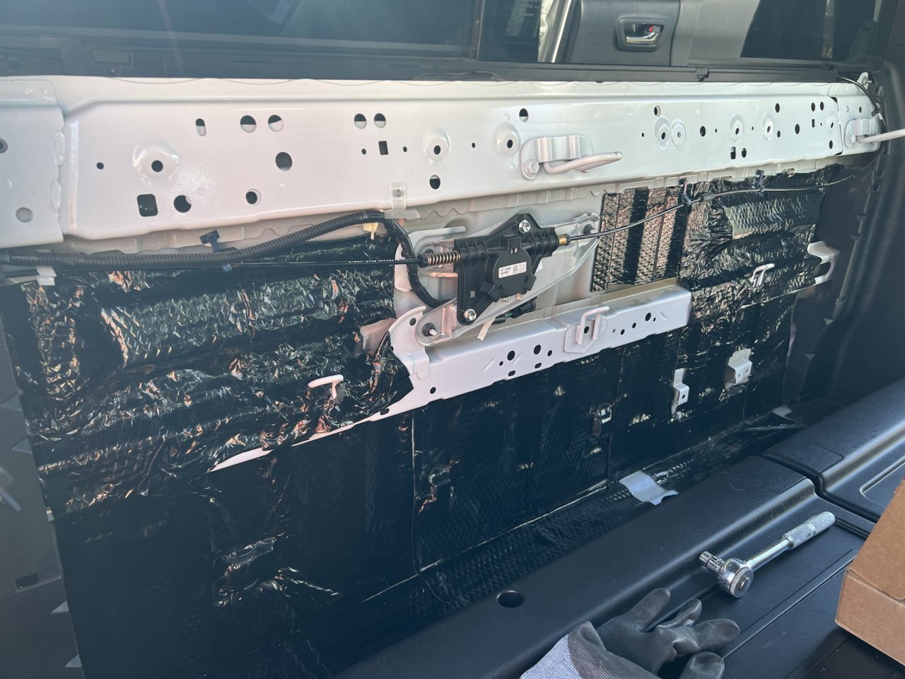

    When installing (retrofitting) a sound system in my (new to me) 2019 TRD Pro Tacoma, I noticed those vents. I thought they'd be an issue. I deadened the hell out of that inside back wall, but I'm getting a TON of noise through there still so I'll try some of these methods. Thanks!

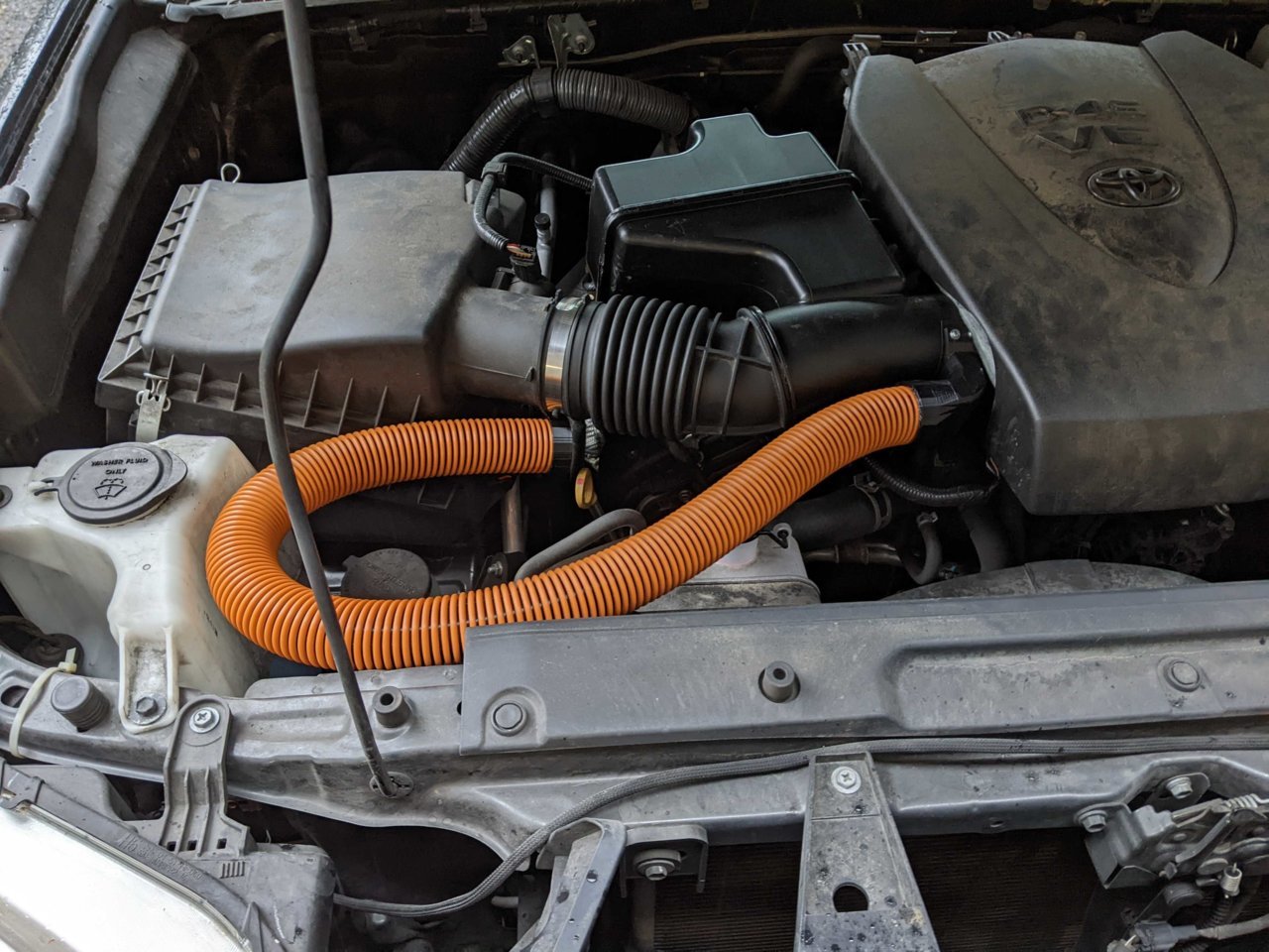

    My next adventure in making a quieter driving experience. Reduce intake noise. I seem to be extra bothered by noise around 100hz - which is where I find the intake/exhaust extra loud. I built a helmholtz resonator and it reduces cabin noise by about 2.5db at 2000rpm. When I accelerate, it has almost completely eliminated the rise in intake noise as the tach sweeps through 2000rpm and the drone when I'm climbing hills at a bit under 2000rpm.
    I need to do more testing and relocate it closer to the air filter box (but where?).
