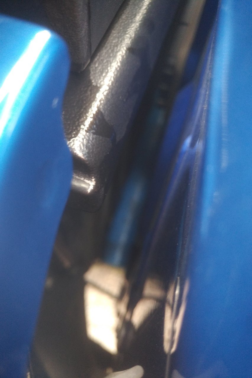

    #326856

    Did anyone manage to snap a picture of magic noodle in place? :cheers:
    I have a gear noise after 4.88 at some rpms was hoping to give it a try and reduce sound coming from the back.

    I fed the pool noodle from the right to the left, overtop of the muffler and then the fuel tank. It is just pushed up enough to be even with the bottom of the cab and box and then tipped the ends down so water could drain.

    Perhaps provide some pics of the front of your Taco and the door seals to see if someone can spot an issue.

    These are some photos I just took at night so my bad if they're hard to see, lol.
