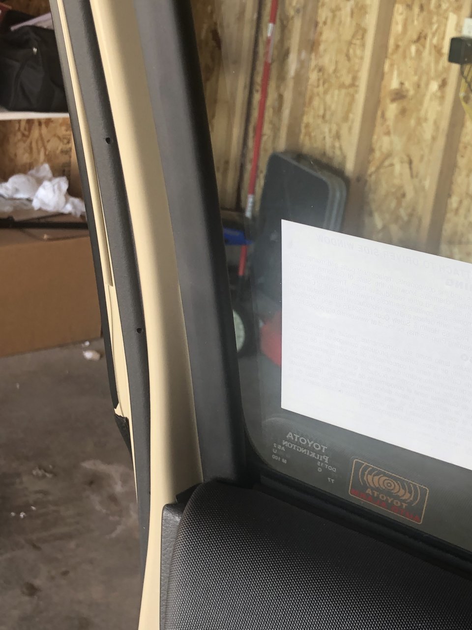

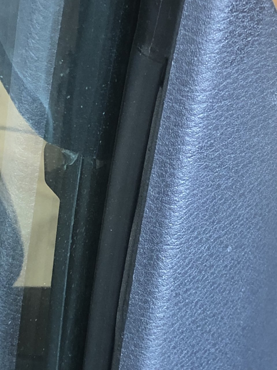

    620F1A0D-5849-45A2-814C-02FFEAF961D5.jpg 620F1A0D-5849-45A2-814C-02FFEAF961D5.jpg 29B9931C-2F45-40B5-BBC9-4875EA86F819.jpg 620F1A0D-5849-45A2-814C-02FFEAF961D5.jpg Noise might be coming from around the drivers side glass/door seal. I bought neoprene foam from Amazon P8225RL00.50XIH.
    I cut a few small strips and placed them on the inside of the seal. This presses the seal tighter to the glass. Problem solved.
