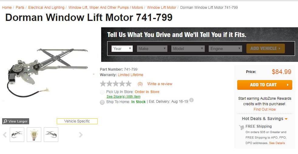

    I bought a DORMAN 741-799. regulator + motor from O'Reilly and installed it on Saturday afternoon. I already had the door panel off to replace speakers so I decided to go for it. The original Toyota motor was working ok. It was just to fix a rattle from worn nylon rollers. So I will keep the original motor in the event the motor goes out.
    EXPERIENCE
    I do run DORMAN regulators and window motors in another car for 4 years without issue. It turns the parts are made in Taiwan. So it might stand a chance of running for a while. Some DORMAN parts are ok in non-critical application space.
    BOTTOM LINE
    The rattle is gone and the window motor seems to be quieter than the old one.

    Thank you - That is the one I got and it appears to be bad.. Ill take back apart to see whats up.
