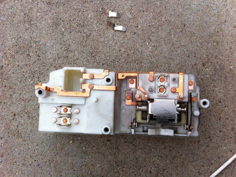

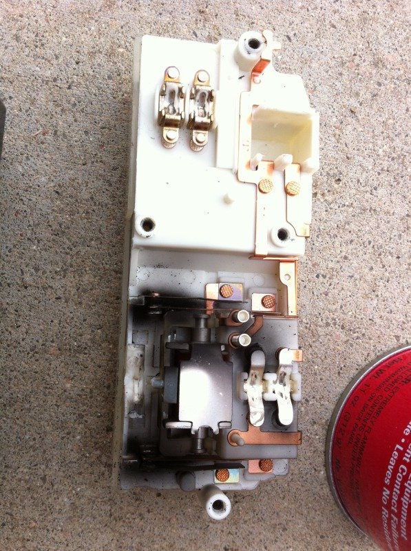

    That's strange, it's usually the up (on the driver's side) that sees intermittent hesitations.
    This suggestion is based on that above ^
    But take the master switch assembly out, takes all but 10 mins and a couple of screws, and clean the contacts with electrical cleaner.
    My driver's side window would be truly hit or miss going back up (I use the auto down most of the time) and it would go up, stop, go up a little more then stop, etc.
    It's because the contacts were so dirty. It's an easy place to start. Plus when you have the assembly out you can further examine it.
    The driver's side window's switches are those long fins (covered in black) that are activated by the plungers on the left side in the first photo. The passenger side window's switches are those rockers on the right.
    Before:
    After:
