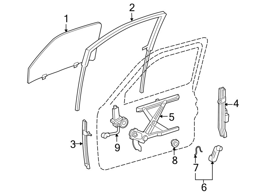

    I've uploaded parts diagram photos of the window seals. Part number two in the picture. The part numbers for the window seals are :
    Driver: 68151-04030
    Passenger: 69141-04030
    The dealer wants 1 hour per side to replace the seals. I usually do all of my own work. I couldn't find any documentation online regarding the seal replacement. I haven't received the new seals yet, but it looks like they may just press into place? Does anyone know the required steps? It looks like I will have to remove the interior door drim, and possibly the side view mirrors? I've had the door trim off, but never the mirrors. I'm assuming it wouldn't be too difficult to do.

    Pull the door panel. I usually pull the door glass it makes it much easier (but can be done with the glass in).

    I'll remove the glass if it makes it easier, thanks for the heads up. Does the old seal just pull out and the new one presses in? I haven't received the parts yet so I haven't had a chance to see what it looks like.

    Yep. The old will just pull out a a new just presses in, easy peasy.

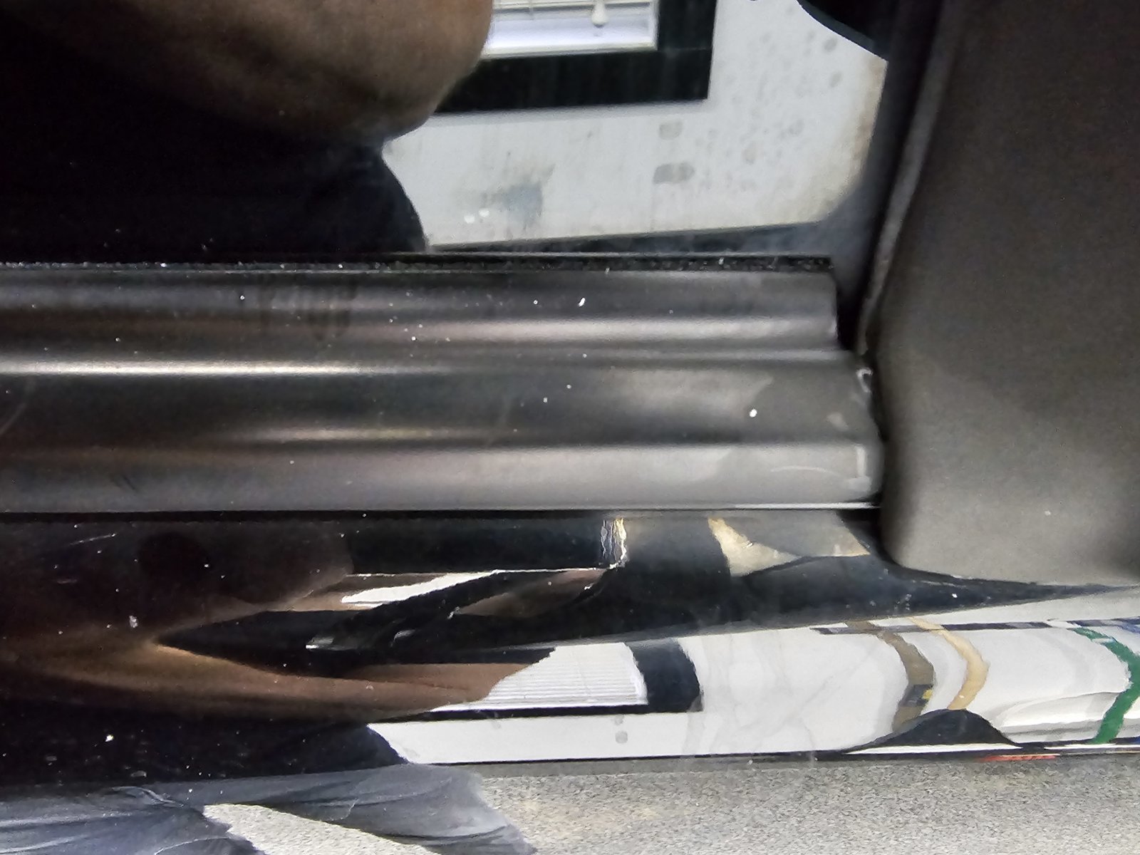

    My window seals were shipped today. I should have them next week. I'm wondering if I should be replacing the exterior weatherstrip for the front door glass as well. The window seals I ordered only seal along the sides and top of the window. I'm wondering if this piece could contribute to wind noise as well?
    If you lool at the exterior of the window, this piece of weatherstrip appears to have gaps on the ends. I'm not sure that it contributes to the seal of the glass?

    if I had any doubts about door seals I’d start by cleaning and treating them for free

    Already tried that. I'm not concerned about the door seals. I've already replaced them with the new part numbers. I'm looking at window seals now.

    It won’t hurt if you do.
