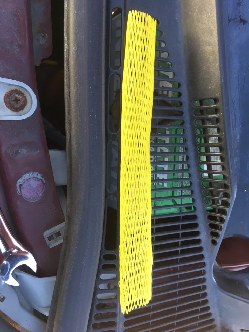

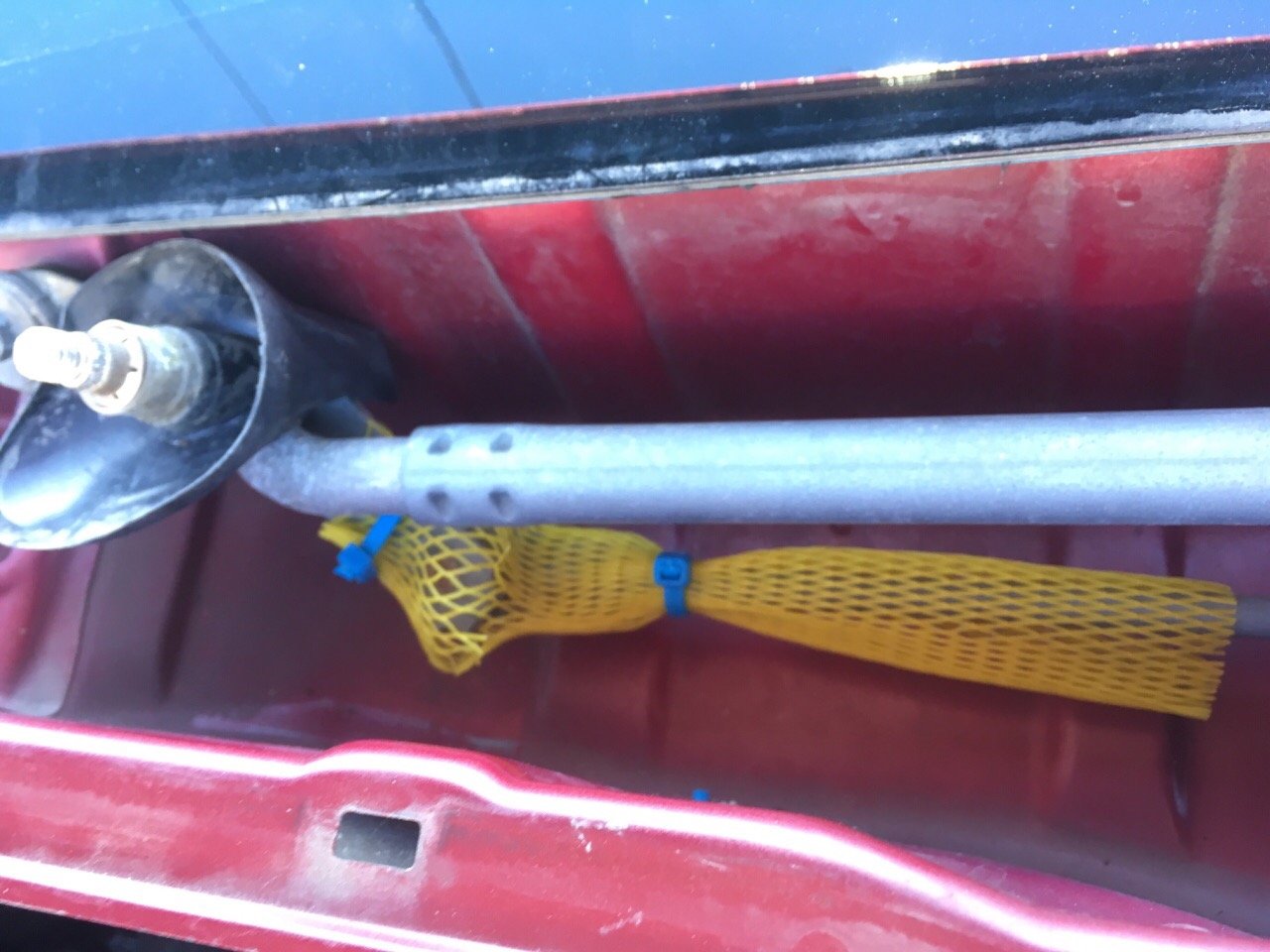

    Update:
    Arm popped off - repaired. Cleaning off my truck during the recent snow - popped off again. Trying this to get me time until I can figure a good repair.

    Well that didn't last long...

    Finally got a chance to finish the repair - between bitter cold and precipitation it's been over a month...
    The repair = a rubber bushing made by Midwest Fasteners, p/n 72632, cost $2.34 - I did have to trim one side of the bushing to allow the ball to seat properly. No drilling required, no nuts/bolts to deal with - trimming was the hardest part, just took time to cut the rubber smoothly.
    Hopefully it lasts...

    Didn't - on fix #4.
    The wire tie guy - what did you use to bind the arms together? Thanks
