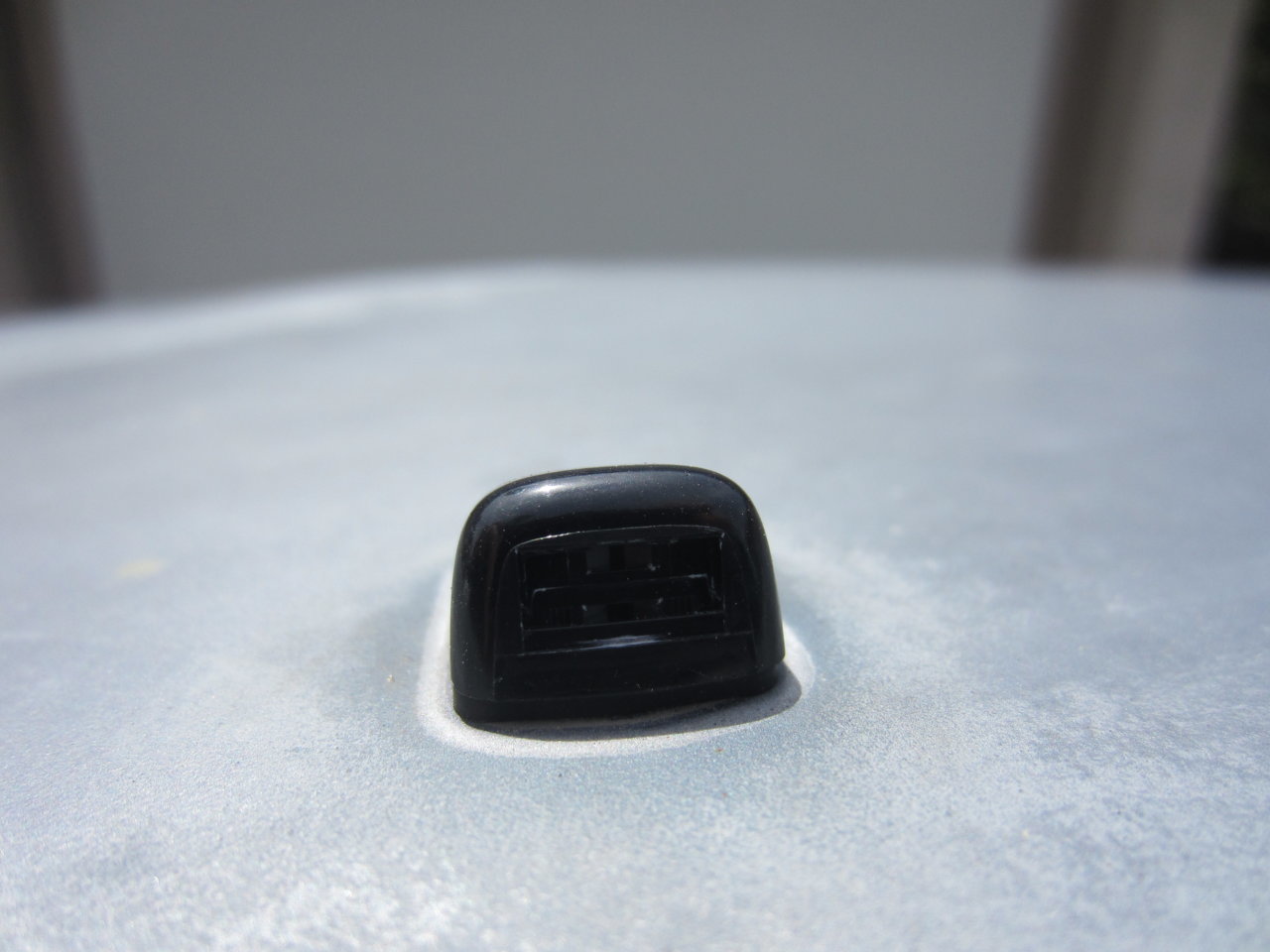

    Finally got my sprayers working again. Also found these online, then went to local Ford dealer and only paid 8 bucks each. Work a LOT better IMO, a fan spray patter instead of the light saber beam of fluid. Still sprays lower on the windshield but uses a lot less fluid and better dispersal.
    Fit perfectly. Part number 8E5Z-17603-A

    Direct replacement, snap right in, perfect fit. A little jiggle/maneuver to get them in place, but fit snug. Connecting hoses after getting them in place is probably the ticket. Hose barbs oriented same direction.
    I'll try to take some pics tomorrow of the spray tomorrow

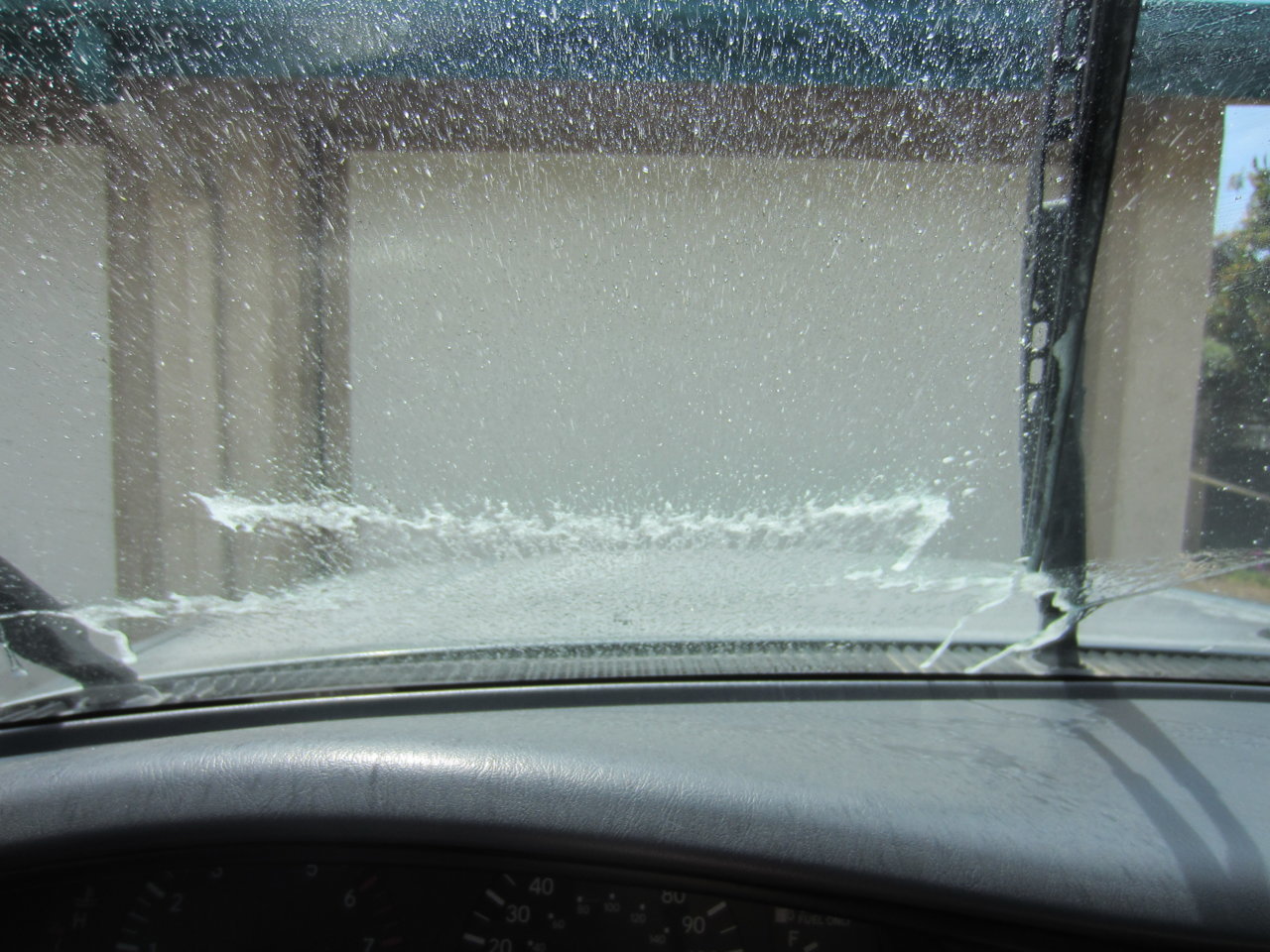

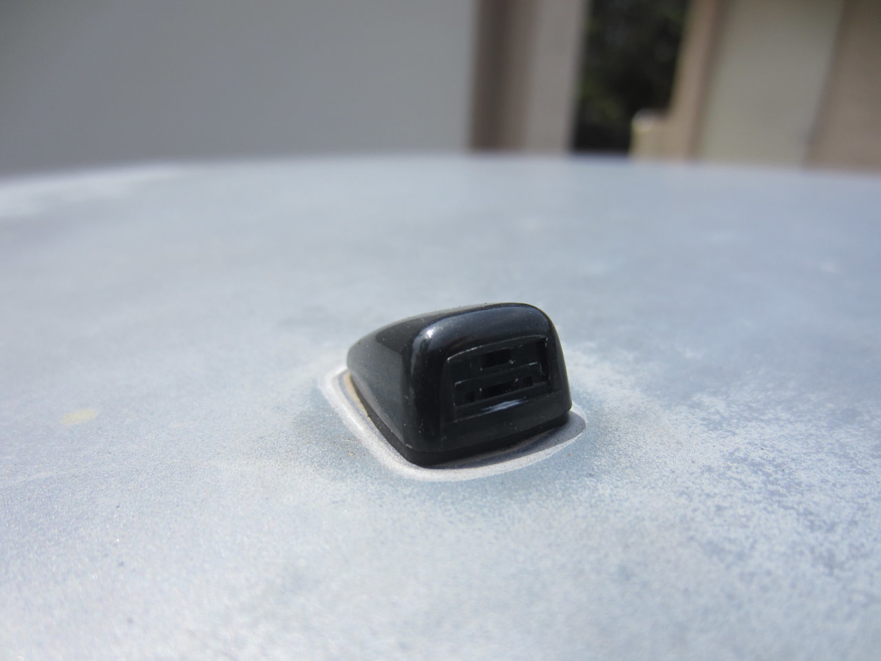

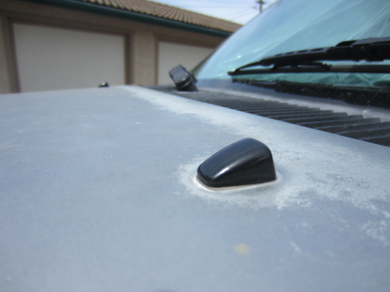

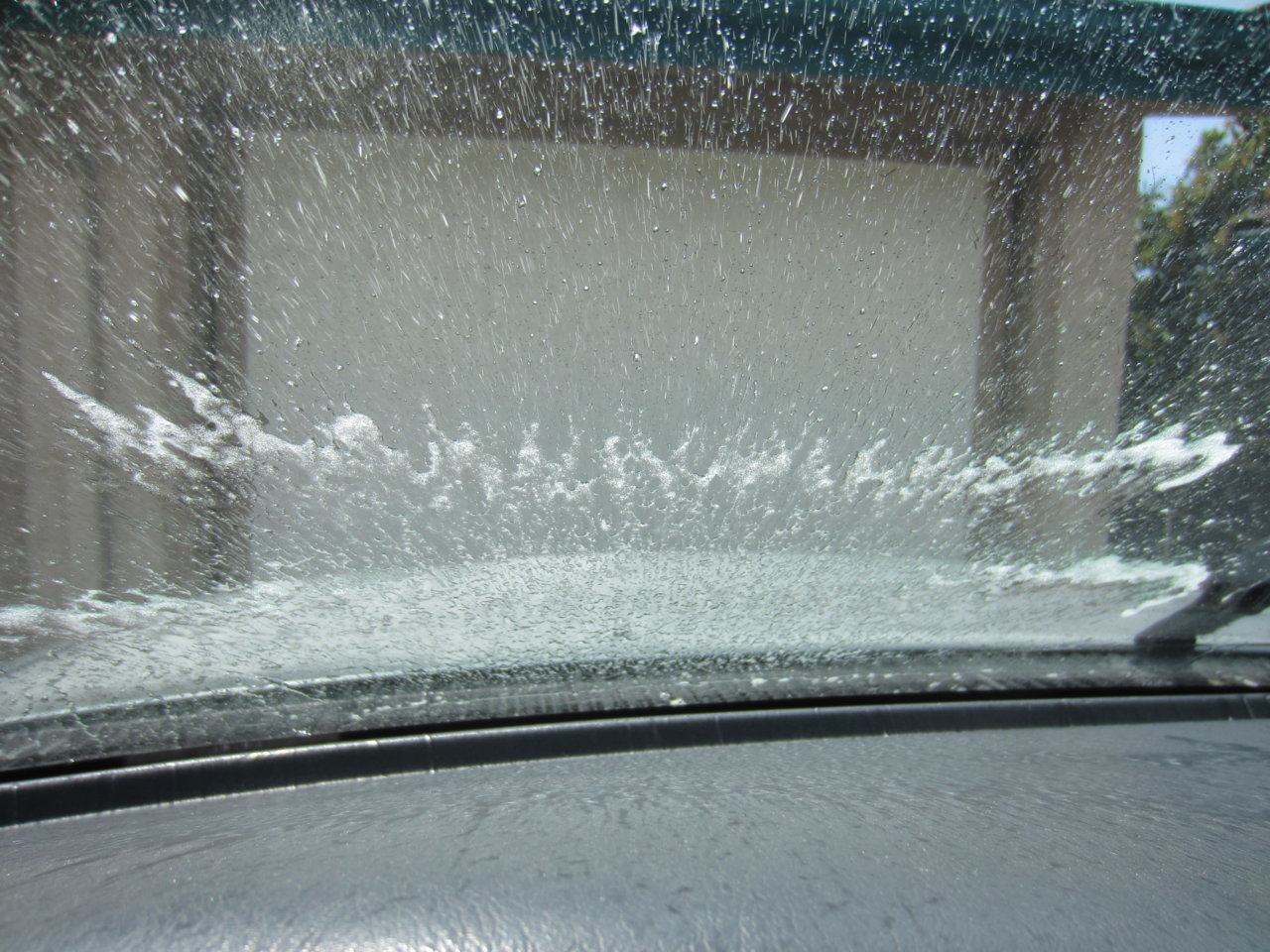

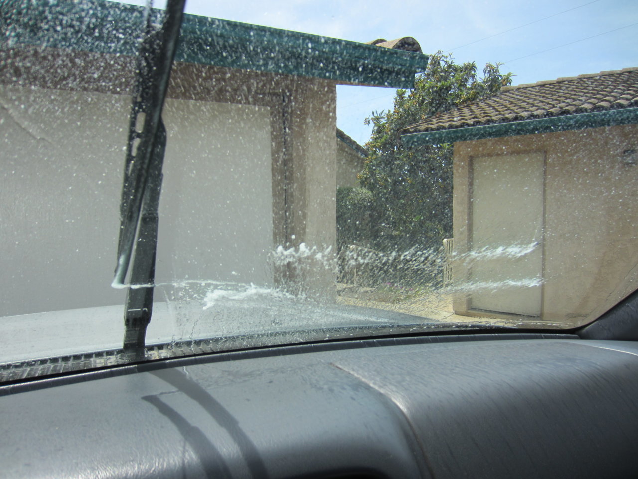

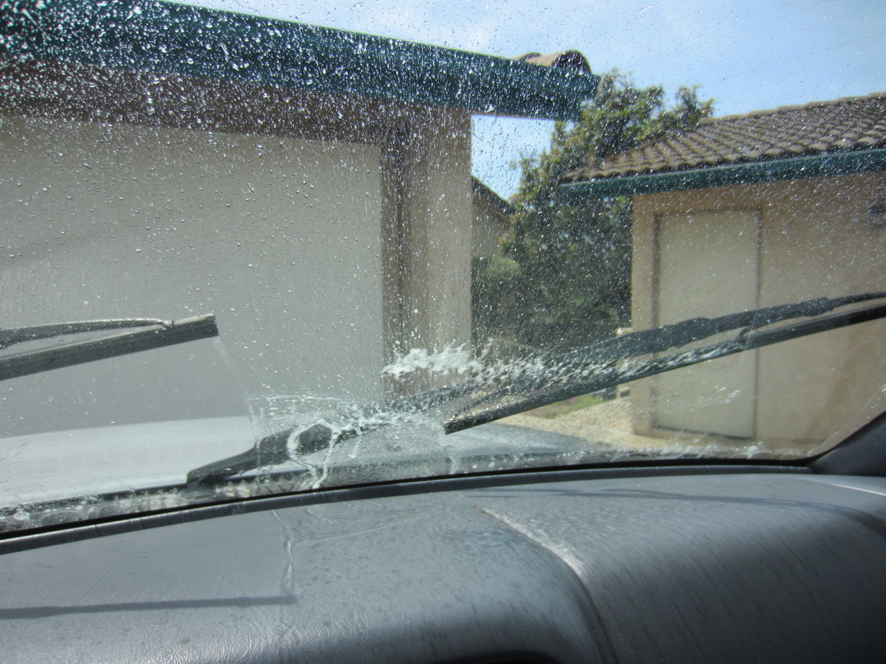

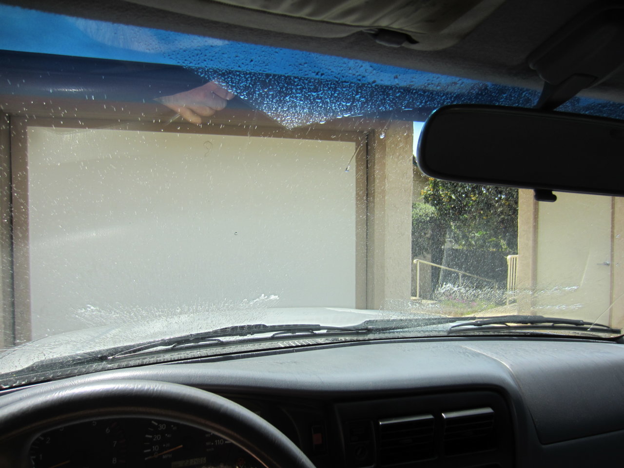

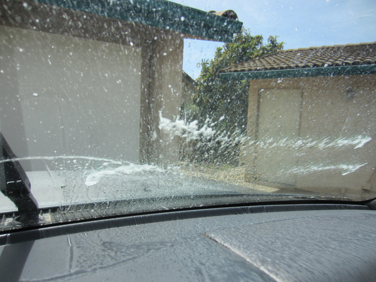

  19. Apr 6, 2018 at 12:50 PM
    #19
    ssoulssurfer
    ssoulssurfer [OP] Well-Known Member
    Nov 15, 2017
    #236115
    303
    1998 Tacoma 4x4 SR5 TRD MANUAL TRANS 3.4L V6
    2.0 FOX COILOVERS FRONT, 5100 BILLSTEINS REARS
    Sorry for the duplicates. You can see it doesn't spray directly over the whole windshield, but there is a lot of spray that ends up towards the top of the windshield. This is also stationary, it helps while driving, the air traveling over the truck carries some more of the fluid to the upper part of the windshield.
