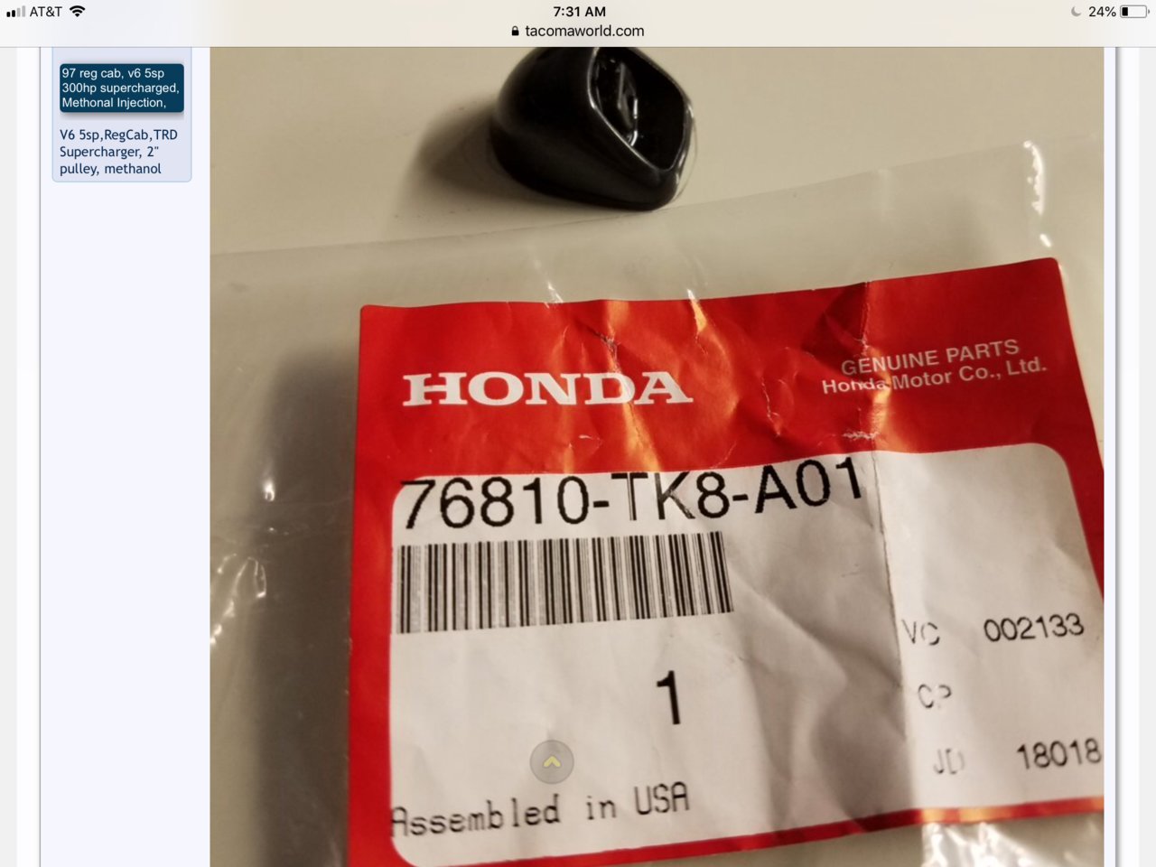

    Thanks for the information on the washer nozzle upgrade. I installed the honda 76810-tk8-a01 today. These are the ones that Toyota should have installed from the factory. With the spray
    Thanks for the info I installed mine today . What a fantastic improvement. These are the ones Toyota should have installed from the factory. Frank
    1997tacomav6[QUOTED] likes this.
