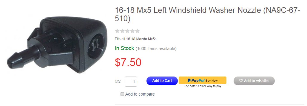

    Your 92 has straight up/down barb as well. I would modify your hood to fit a larger sprayer or modify a bigger sprayer to fit but you run the risk of puncturing the side of the sprayer and ruining it. I would get these and cut the hood to fit. They are fan spray and adjustable.
    https://www.atkinsrotary.com/store/16-18-mx5-left-windshield-washer-nozzle-na9c-67-510-.html

    Something I ran into when I put in a sprayer that had the 90 degree angle on them was that it didn't quite clear the hood. Did these go in no prob or did you have to do a little bit of trimming?

    Mine went in with ZERO MODIFICATIONS and work fantastic

    +1 on these sprayer nozzels!
    After trying 6 different types, these are the golden ticket! Perfect spray width, and the adjustability of being able to set the elevation of the spray makes it spot on.
