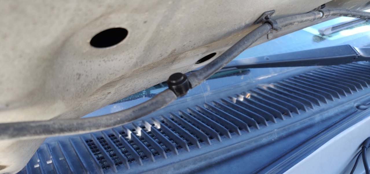

    I want to say I also redid the hose routing so that each nozzle had the same length of hose from the T. I didn't like that the driver side took longer to spary.

    Too soon to say in case it takes quite sometime for the fluid to backflow back into the tank but check valve installed. There is no flow direction shown so you have 50/50 chance of getting it right the first time around haha.

    sweet let us know if it holds.
    i would have put it closer to the tank myself though

    So good news is 24hrs later, no delay, water right away.
    Bad News, was getting some stuff at Lowe's and saw some Gucci windshield fluid and got it too. Loaded her up, started some extended spraying and the system seems to have lost lots of pressure, barely gets any on the windshield. I think only using water for a long time + age, the pump internals are gone, the chemicals in the Gucci fluid wrecked the old girl.
    So new pump is on the way. I have an aftermarket bumper and the older school reservoir setup is tempting but I want to keep cruise control... But my OEM reservoir has the infamous neck degrading issue. Its very tempting to go with the below universal reservoir, looks like it would fit with cruise control and the catch can and additional fuse/relay box I have in that area.
