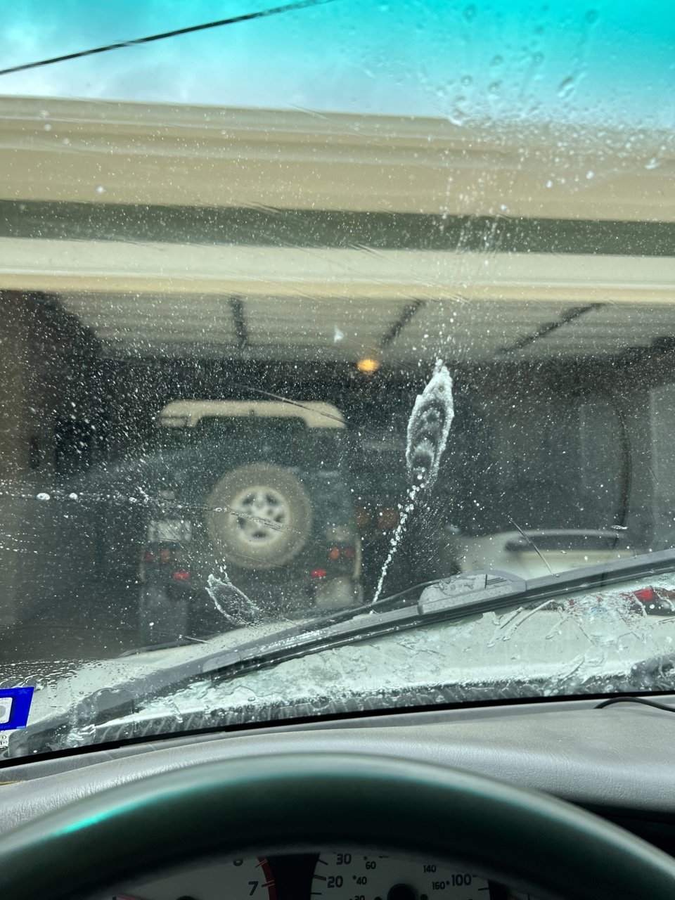

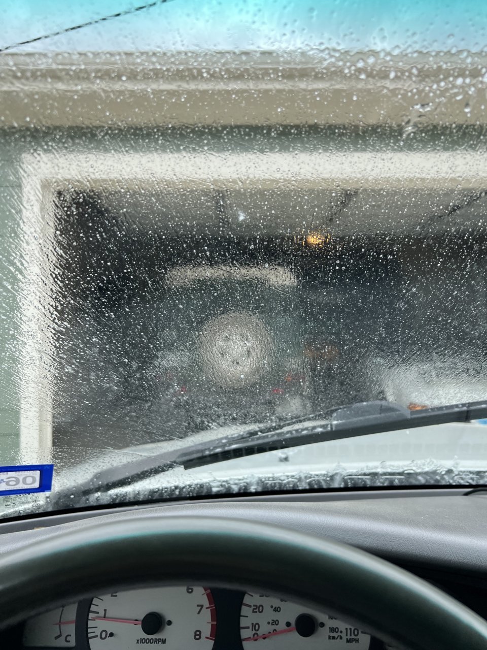

  19. Apr 18, 2023 at 2:58 PM
    #279
    wjcunningham3
    wjcunningham3 Well-Known Member
    Jun 23, 2020
    #332333
    69
    Joe
    2002 Lunar Mist Tacoma TRD V6 4x4 Manual
    Mostly stock - but I do have a suction cup phone holder - its pretty sweet
    Wow - that was easy and quick!! Thanks for the info y'all!! This is the before and after. HIGHLY recommend this!
