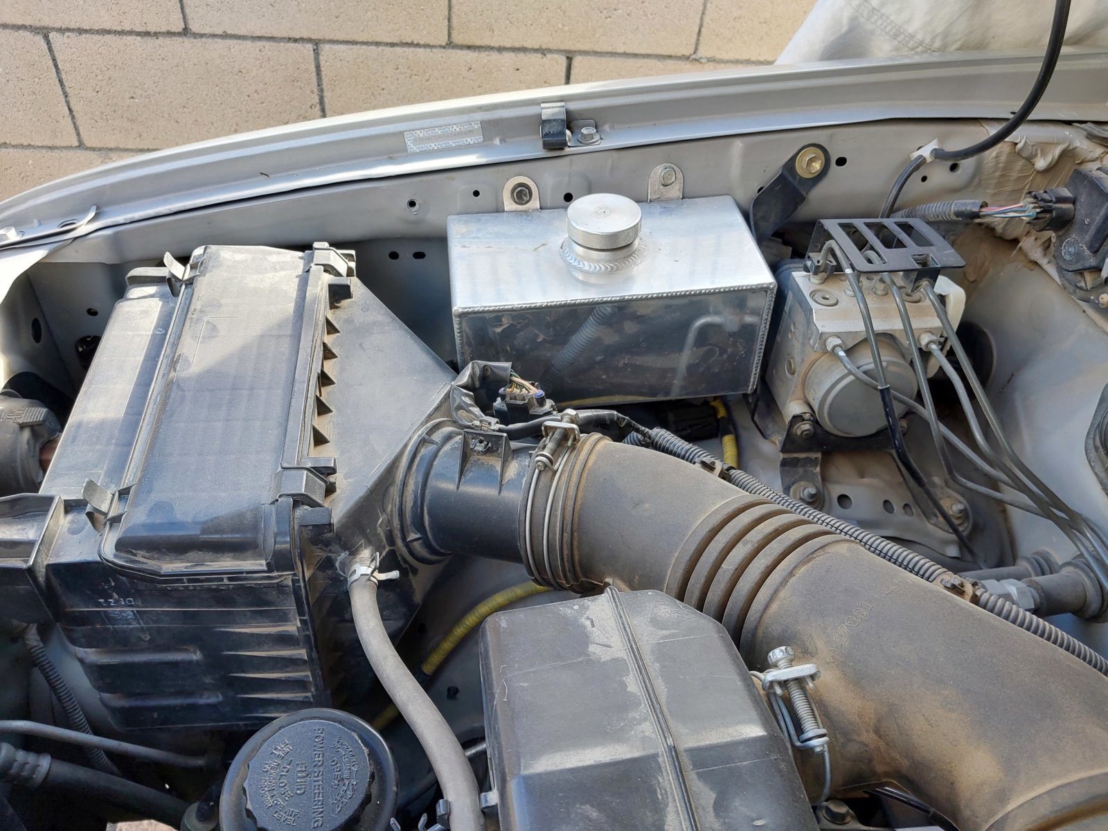

    This is definitely one of the best bang for the buck mod I have done too.
    I removed the factory windshield fluid reservoir because of suspension mods.
    This tank is a perfect fit. Even the mount holes lined up with existing fender thread nuts.

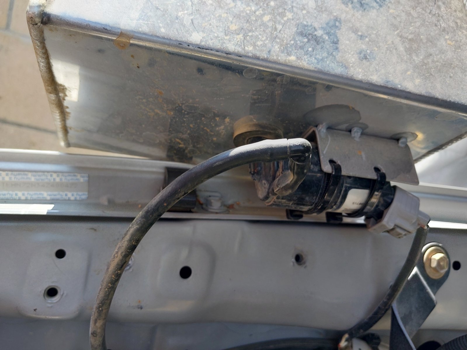

    I bored open the bottom hole of the tank to use the OEM washer pump and wiring. I was pretty sure the grommet supplied with the new tank was going to leak.
    Amazon.com: Qiilu Windshield Washer Reservoir Tank, Aluminium Windscreen Washer Bottle 2L Polished Intercooler Spray Tank Universal Car Parts : Automotive

    This tank is still working well, no leaks and the mounts have not cracked.
    There was only two issues. The cap is airtight and after a little spraying the fluid stopped. A small hole in the cap allowed venting and all is good.
    The other is trickier. The supplied pump and grommet were poor. It leaked all over the igniter in a few minutes. I adapted the OE pump and grommet to the aftermarket tank. I work in a machine shop, so I was able to bore out the hole on the bottom of the tank to fit the OE grommet. I measured the OE grommets outside diameter and bored the hole .010" under that. I also aluminum brazed a bracket to support the pump.

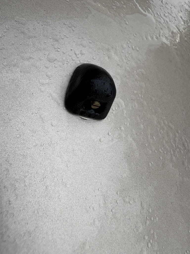

    Clock Volt meter/LSPV Delete/Hyundai 16’s/FP gauge/after 9months of wrenching ZERO oil leaks
    I’m extatic with the eBay Odyssey ones I installed
    Took longer to adjust than to install
    The AM ones I took gamble on were lil more expensive than other cheap ones
    But
    Clearly showed a small brass round adjustable sprayer
    lemme take a pix when stops raining
    Btw that alum washer res is Boss!
  16. Nov 18, 2024 at 2:36 PM
    #296
    ControlCar
    ControlCar My Moto: Help & Learn…period.
    Jul 22, 2023
    #429578
    3,109
    Steven
    Sugar Land TX
    1996 Taco 2.4L 2wd Automatic
    Like this
