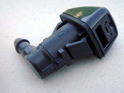

    Thought maybe nozzles from a landrover or rangerover might be different but they are the two hole like the 4runners. Wonder about ones from a jeep liberty?? One like this..

    It sprays high but not high enough in my opinion. Could do with a bit more angle.

    That's the best one I've seen so far. I didnt realize that was the jeep liberty nozzle in the post you had posted earlier. Is it a direct fit?

    Not quite, you have to trim the bottom of the hood to allow the barb to fit. The base is the same as stock but instead of the barb pointing to the passenger side it points to the front of the truck.

    Ah! I didn't realize these were Jeep Liberty sprayers. That's pretty awesome. I'd be interested in doing that! Do you have a part number?

    I think both of these are similar. part#4806312AA, 68033222AA.
