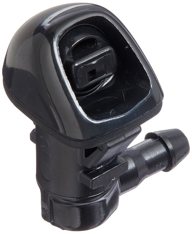

    So I just installed these and I don't think you will find a better replacement. I can actually aim them above my windshield if I wanted. Popped right in, didn't need to shim them or anything.

    I just ordered 2 so I'll let you know. The dealer sells them for 8ish so I'm assuming it's 12 for a single sprayer. Should arrive by Wed.

    And yes they are $12 each. I haven't driven with them yet but I don't think there will be any issues.

    I will say after further testing that these Honda sprayers are as good as it's going to get, unless they make one with two fans per sprayer. At speed on the highway the spray is even better. At a stop it sprays a little heavy at the edges but on the highway it's coverage is uniform and each sprayer covers at least a sqft of the windshield. I'll make a gif from my dash cam video tonight.

    is it true that you can move them side to side as well as up/down?

    I've only done up and down but according to Mazda you can.

    Yes they are a ball pivot joint. I stuck a small flathead screwdriver in there and moved it around.

    Just got mine in, perfect fit and spray pattern and yes you need to adjust them up,
    Side to side was just fine but you can adjust any direction. They are taller than stock abit
    All plug and play and took 5 minutes to install and adjust
    These are definitely the ones to buy
