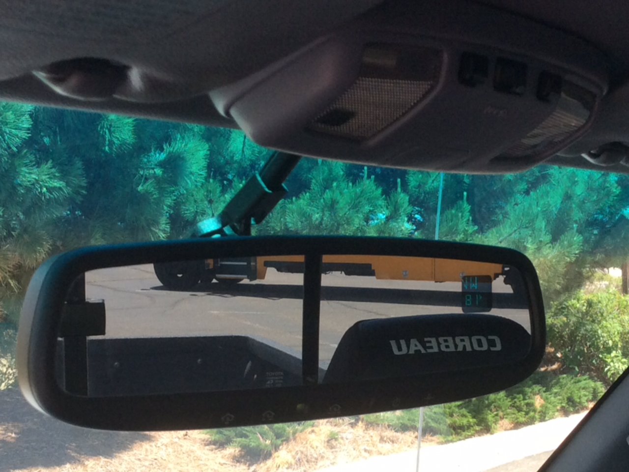

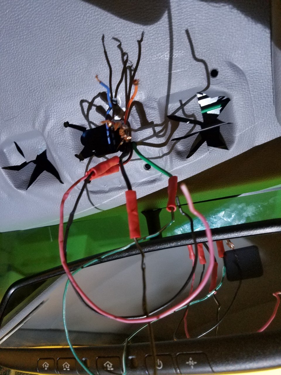

    You bet, now that this mod is done back to installing my gentex homelink,compass, temp, auto dim mirror, now for the electrical part :)

    Hope it comes with a write up, I’ve been eyeing one of those Gentex mirrors.

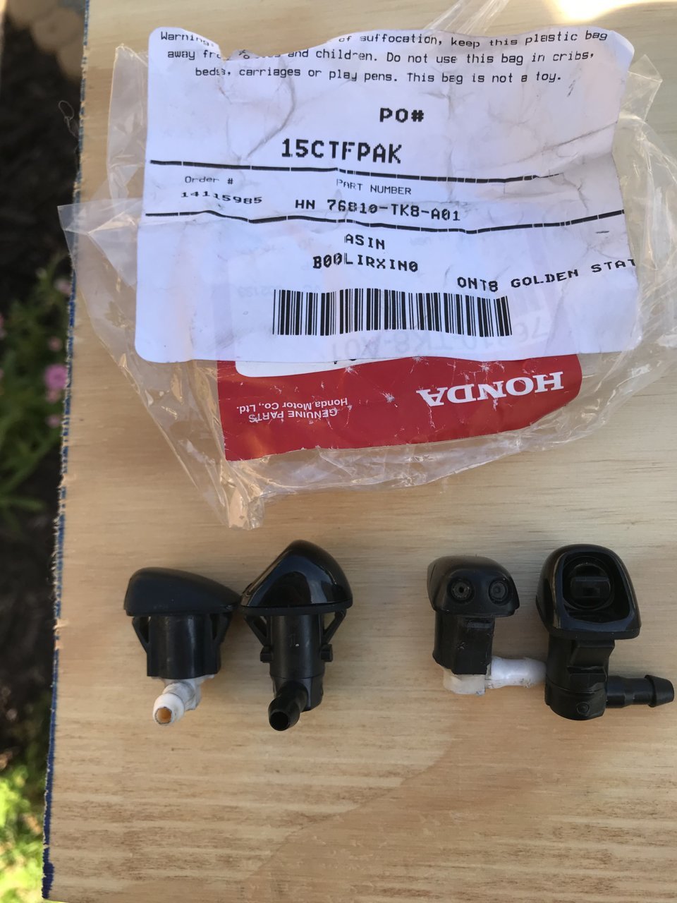

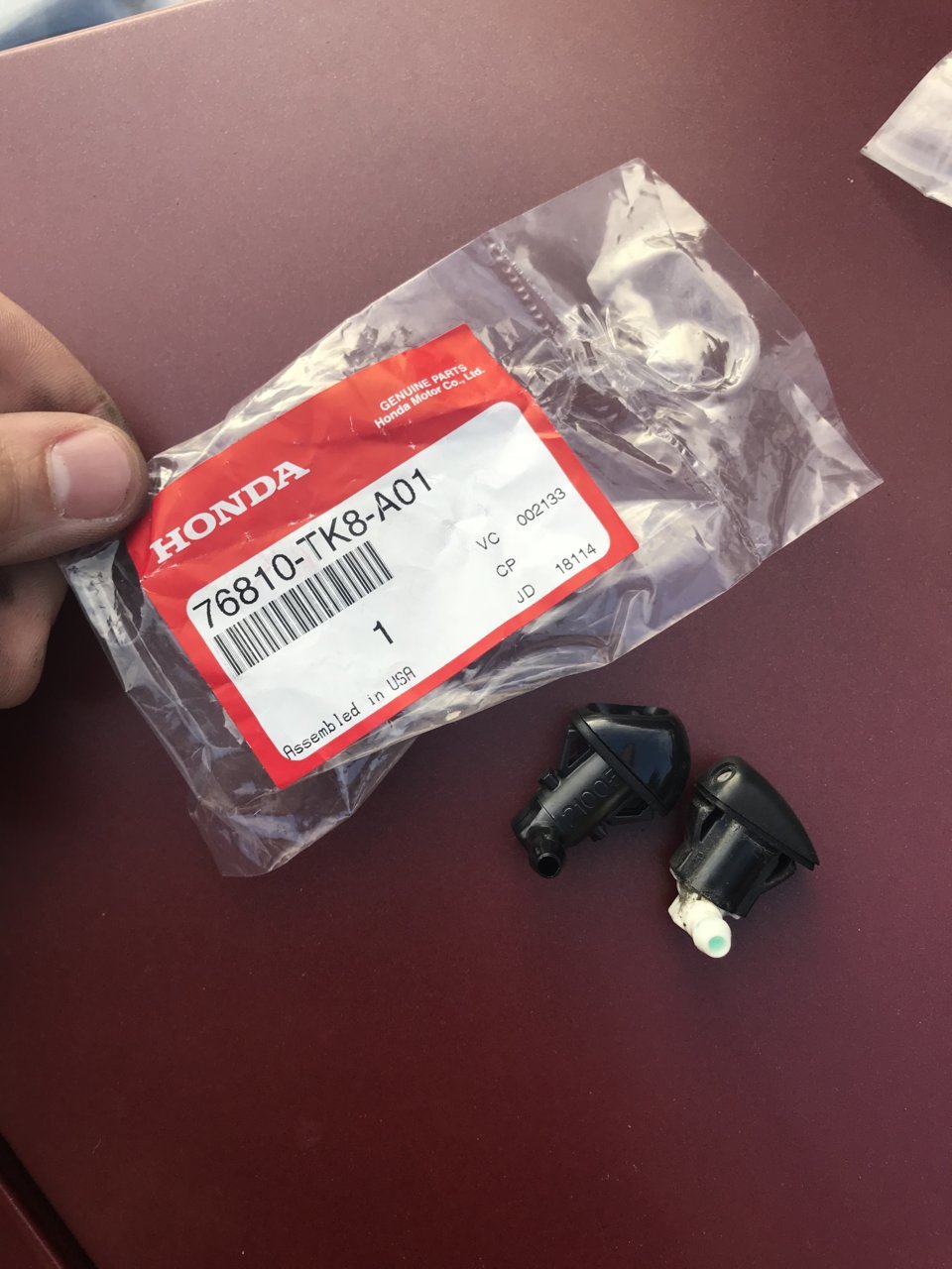

    I got the honda ones and they work perfectly. They snapped into place like it was meant to be!

    I installed the Honda Odyssey nozzles yesterday, picked em up at the local stealership 2 blocks from my office. Incredible difference, took me every bit of 5 minutes.

    Got a new windshield and decided to run the Odyssey nozzles. Such a HUGE difference!
    They provide way better coverage, and they do great at high speeds once you dial in where they hit the windshield.
