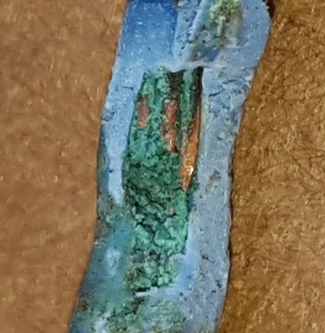

    I had the same problem today: wipers came on by themselves, would not shutoff, and washer would not function. I had to stop and pull the fuse.
    Thanks to previous posters, I went straight to the washer tank area wiring. Thought I would add pics of what was wrong with my truck (1995.5).
    Noted pinched/melted looking section of wire. Oddly, there is no pinch hazard in that area. I believe it must have happened during manufacturing of either the W/H or the truck. This is the body side of the harness that connects to the pump.
    Closeup, after I shaved off some insulation, you can see the damage inside. I unplugged the washer pump and the wipers functioned normally.
    Cut, twisted, soldered, and taped. All good.

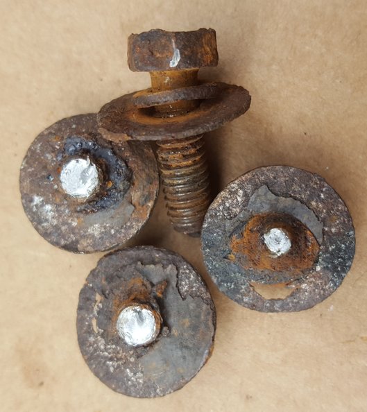

    BTW, I had to remove the tank cover, which is bolted and it is the same bolts that hold the tank. If you live in the rust belt, expect:
    3 out of 4 bolts twisted off. Drilled 3 new holes right next to the originals and used one zip tie.
