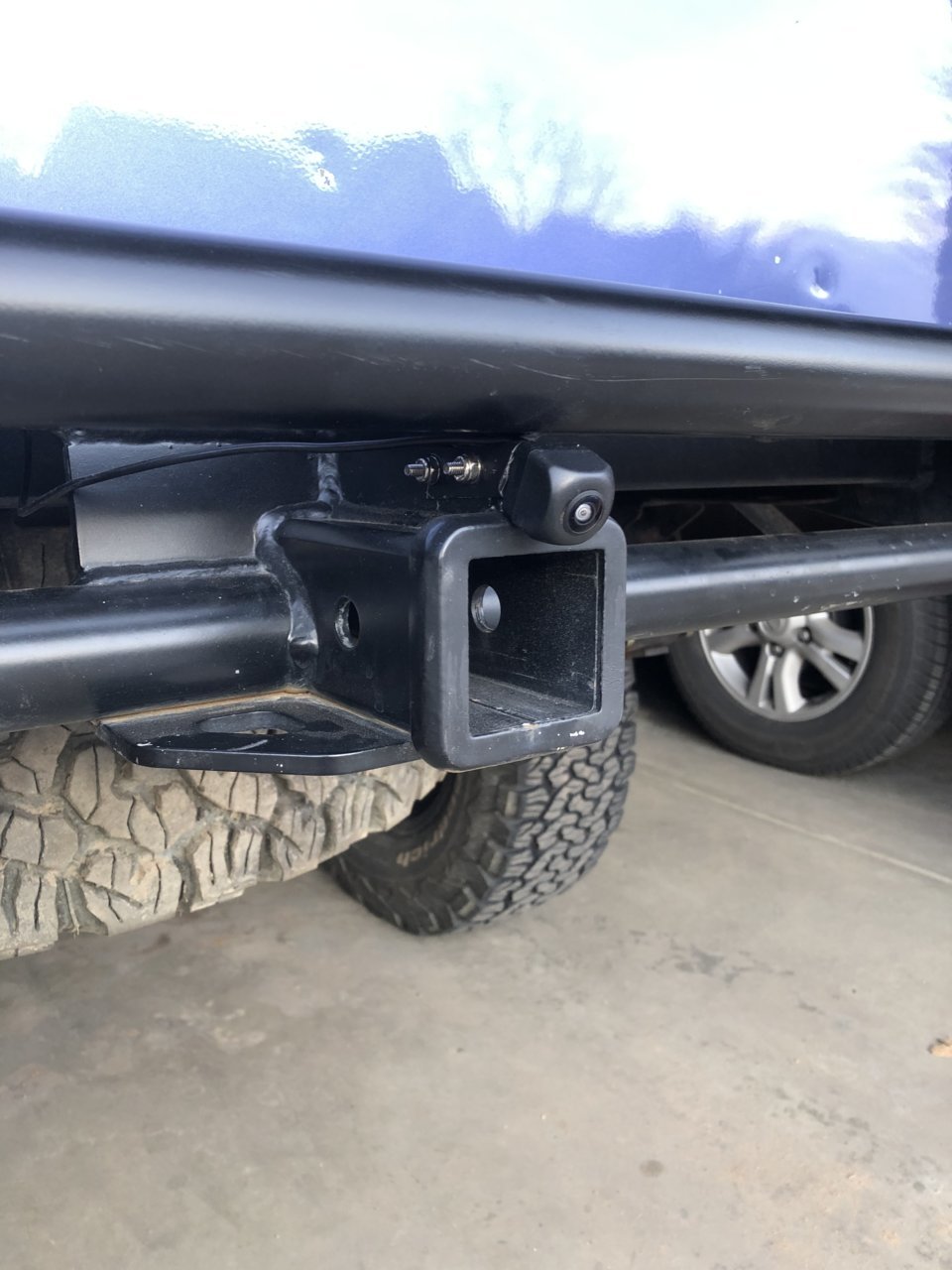

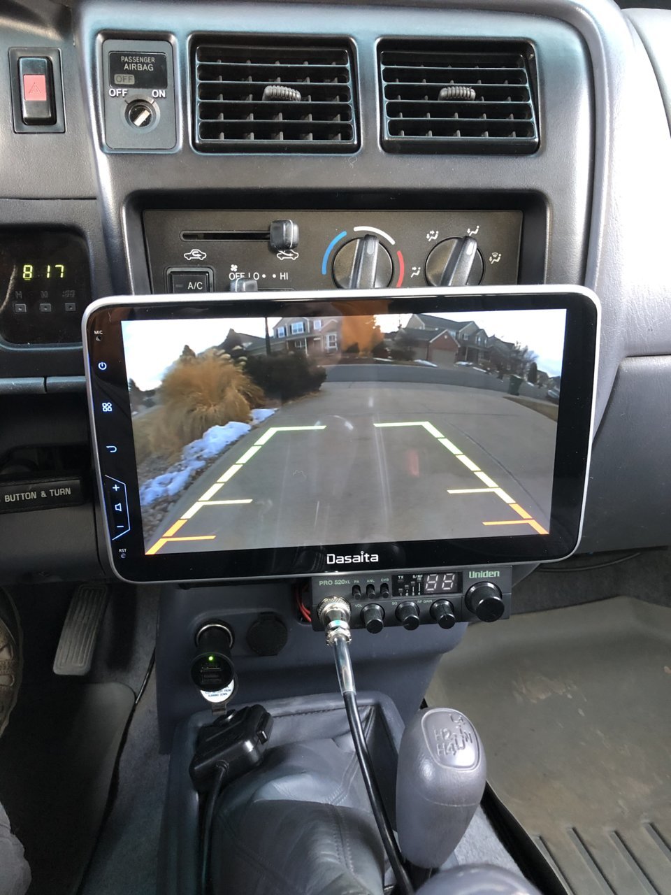

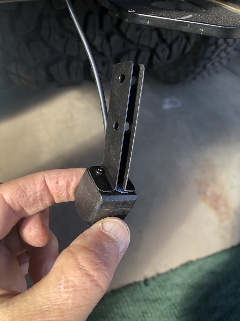

    I installed the backup camera. I created a 2 piece bracket out of sheet metal, drilled a couple of holes in the gusset of my 4xInnovations bumper, and attached with stainless steel hardware. The bracket has a 30 degree angle, which matches the angle in the universal bracket that came with the camera.
    I spliced into the wires for the rear light on the drivers side tailight to provide power to the camera when I shift into reverse. I plugged the camera’s RCA connector into the Dasaita RCA connector labelled VIN (video in). I also soldered the camera power wire to the Dasaita wire labelled BACK.

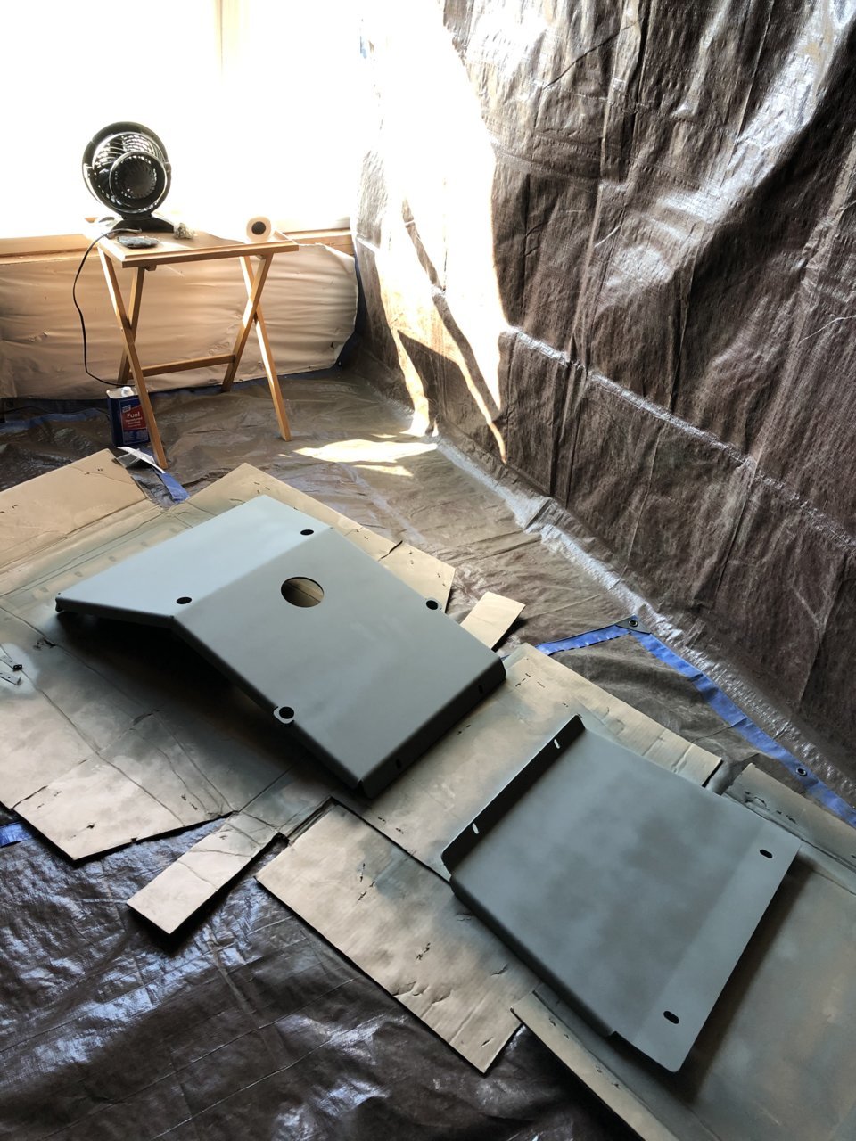

    Spray painted Winkle’s skid plates today with Rust-Oleum self etching primer in a make shift basement paint booth. Used two 12’ x 12’ tarps hung from the rafters and a fan to exhaust the paint fumes out the window. I would normally paint these outside but it is warmer in the basement today. The 4xInnovations plates get their final coats of Rust-Oleum flat black enamel tomorrow.

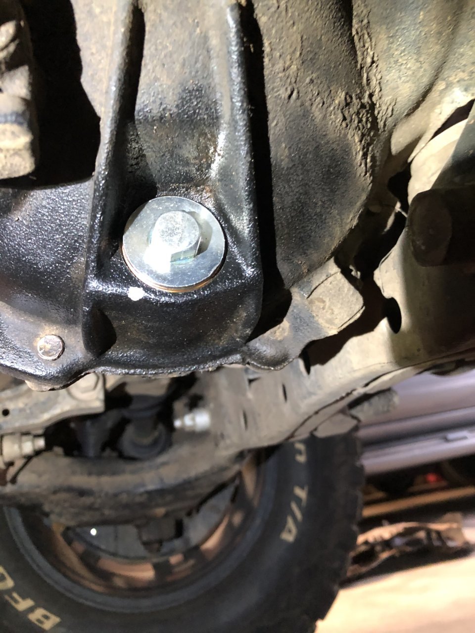

    I performed some preseason maintenance. Checked torque on various bolts, changed engine oil, changed front diff, rear diff, transfer case gear oil, rotated tires.
    Added the Lexus front diff drain plug (part number 90341-24-16) that @turbodb and others recommend. Fortunately, I had no problem loosening my stock allen head drain plug but its deformations indicated someone in the past did have problems.

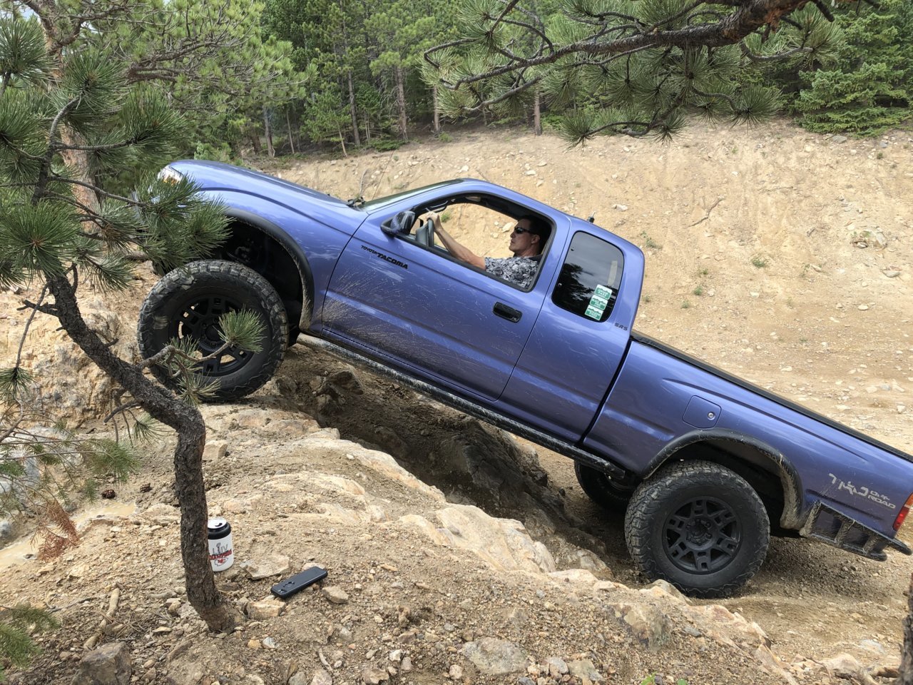

    7/25/2020 Met @johntoyota and @Littles and rode the Switzerland Trail as well as Pennsylvania Gulch. It was a partly cloudy day, which kept the temperature pleasant and the previous day's rain kept the dust away.
    We found a fairly steep set of rocks to climb. John made it up with no problem. I failed in my attempt due to a poor line choice, poor clutch and throttle control, and my obstinance to run street tire pressure until I find a case where it is needed like in sand and snow. Well, I think I found a case where it may have helped since I slipped off a rock and baptized my new skid plate. But, I think it was my poor line choice that was the dominant cause.
    Bryan went next. He also runs a manual transmission. It was quite the education for me to watch "Three Tons O' fun" crawl up and over with his recently installed crawl box. So much smoother than I.
    Pennsylvania Gulch was a fun challenge. There was enough steepness, rocks, and exposed roots that I used the easy button a couple of times just to make sure I climbed over some larger obstacles. The max off camber was 25 degrees. I only have this poor quality video of Bryan crawling up.
