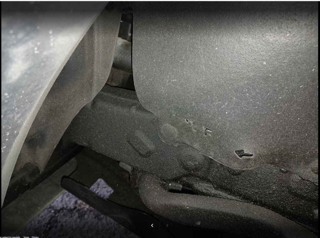

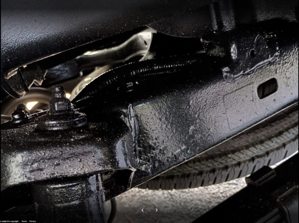

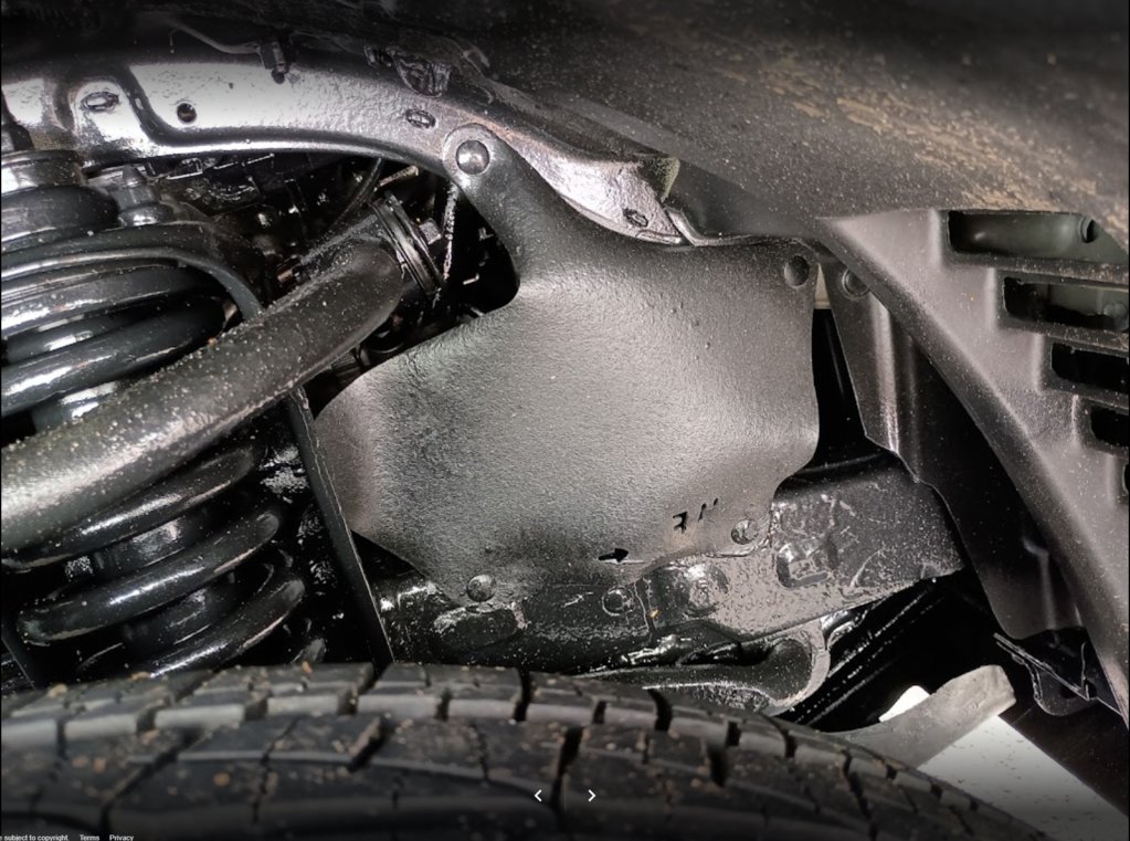

    Woolwax / Fluid film or Krown is great, its like oil petrol that coats and creeps in every corner of the truck. Over time it will gather and stick all the trash and dust from roads and forms coating that breathes and protects.
    I had it done in summer, because I wanted it to attach all the trash and debris and not wash off during rainy fall and it did work, its almost like thick layer now that i touch, kinda freezes in cold.
    You can also keep washing it everyday like others have said, but in freezing temps i dont think that's safe

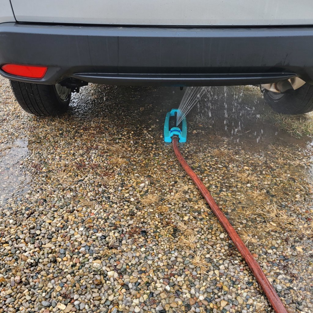

    I live in the same area. Sick of the salt.
    Went to my local gas station touchless last night about 8:30pm. It was all backed up with a 35-40 minute wait!
    So I decided to try my local pay and spray instead. It was -3, at 9:00 pm, open air wash bay. Used the wand to pressure wash the worst of the salt film off the exterior and underneath of the truck. Then used the foam brush ****GASP**** to wash the truck body to get the remaining salt and road grime off. Wasn't too bad as I like to keep this crap off as much as possible. Don't leave it too long in between tho IMO.
    Left there and upon my first stop. the rear brakes ceased up momentarily. As I went to accelerate, truck hesitated like the e-brake was still applied. The rear brakes made a noise once they broke free, truck moved freely after that. Made sure to continue to drive around until brakes were heated up.
    Some things I do in these conditions.
    - I take my truck to the gas station touchless as often as required in these salty conditions. Opt for the extra charge of an undercarriage rinse if possible.
    - I will also do the pay and spray as necessary. Usually just the pressure washer without the foaming brush for 5$. Make sure to hit the undercarriage as well.
    - Every early fall I do a full detail with a clay bar and finish with a cheap affordable Turtle Wax spray ceramic coat. Surprisingly works quite well all winter.
    - Late last summer, I did a complete application of CRC rust inhibitor by hand. Crawled around on my gravel driveway and hand prepped to get the worst of the road grime and dirt off the frame. Then applied 7 cans of the CRC rust inhibitor.
    - I have a underground parking spot that is open air. The temp always remains above freezing so I can still put the truck away wet in extreme cold after a car wash.
    At work and just went out and had a look at the truck. Looks awesome. Especially compared to all the other salt covered vehicles out there.
    Anyhow, at a minimum I'd just gently pressure wash the truck off every 3-4 days including the undercarriage to keep the salt off.
