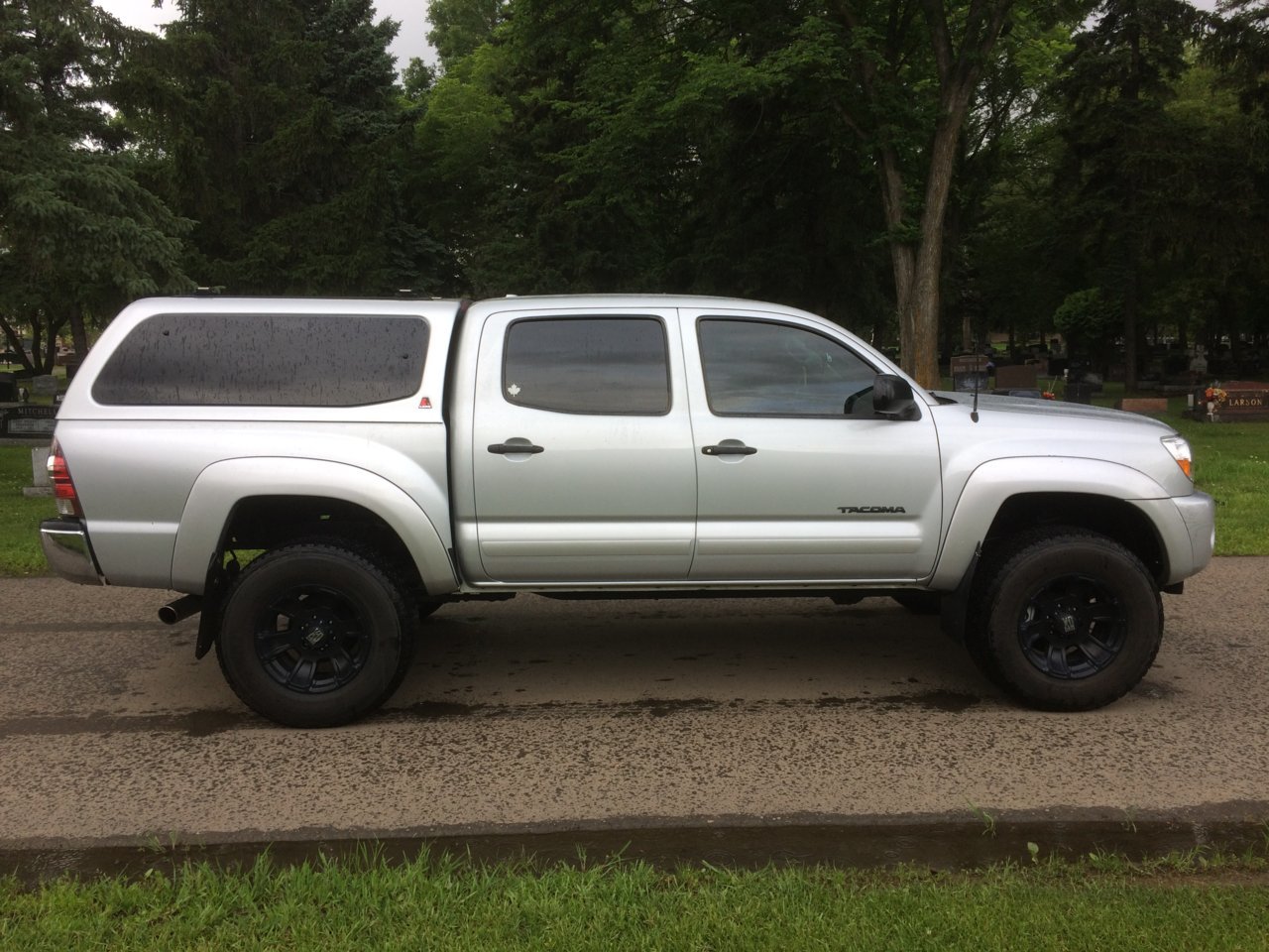

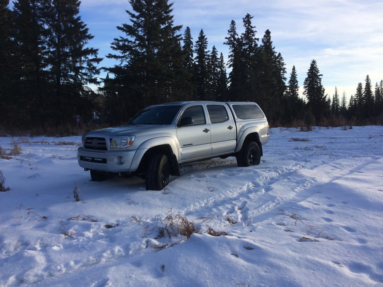

    Hi all!
    I'm retiring my Blizzak DMV-1s and am looking to move to Hakkapeliitta Lt3 studded.
    I'm running 285/70/17 and the Blizzak have discontinued the DMV-1s and have no 285/70/17 in the DMV-2s.
    The Hakka LT3s DO come in a 285/70/17, studded and non-studded and are rated at 121 load index (3100) and are 45.2 pounds
    The Blizzaks are load index 118 (2833) and are 46 pounds
    Can anyone with tire experience, or especially Blizzak to Hakka LT3 experience, tell me if this will make any significant difference in handling or stiffness with the load index increasing from 118 to 121?
    According to the quote below, "equal or greater" is acceptable.
    At 285/70/17 I run 27 psi and get a great ride and tire wear.
    There are multiple other tire options in the 265/70/17 size. I prefer the 285s for appearance as the truck is lifted.
    I live in Edmonton, Alberta, Canada and we have a LOT of snow and black ice throughout the entire winter.
    I just put a TrueTrac in the rear, so that will help, but studs will be the clincher for ice.
    I'm not wanting the truck to ride like a little red wagon, if the LT3s are too stiff for the weight of the Tacoma and would like some real world opinions.
    Thanks all!
    The load range/ply rating branded on a tire's sidewall identifies how much load the tire is designed to carry at its industry specified pressure. Passenger tires feature named load ranges while light truck tires use load ranges that ascend in alphabetical order (letters further along in the alphabet identify stronger tires that can withstand higher inflation pressures and carry heavier loads). Before load ranges were adopted, ply ratings and/or the actual number of casing plies were used to identify the relative strength with higher numeric ratings or plies identifying tires featuring stronger, heavier duty constructions.
    Today's load range/ply ratings do not count the actual number of body ply layers used to make up the tire's internal structure, but indicate an equivalent strength compared to early bias ply tires. Most radial passenger tires have one or two body plies, and light truck tires, even those with heavy-duty ratings (10-, 12- or 14-ply rated), actually have only two or three fabric plies, or one steel body ply.
    In all cases, when changing tire sizes or converting from one type of size to another, it is important to confirm that the Load Index in the tire's service description of the new tire is equal to or greater than the Load Index of the original tire and/or that the new tire's rated load capacity is sufficient to carry the vehicle's gross axle weight ratings.
    "The load range/ply rating branded on a tire's sidewall identifies how much load the tire is designed to carry at its industry specified pressure."

    Anyways... hope this is usefull to someone looking for tires.
