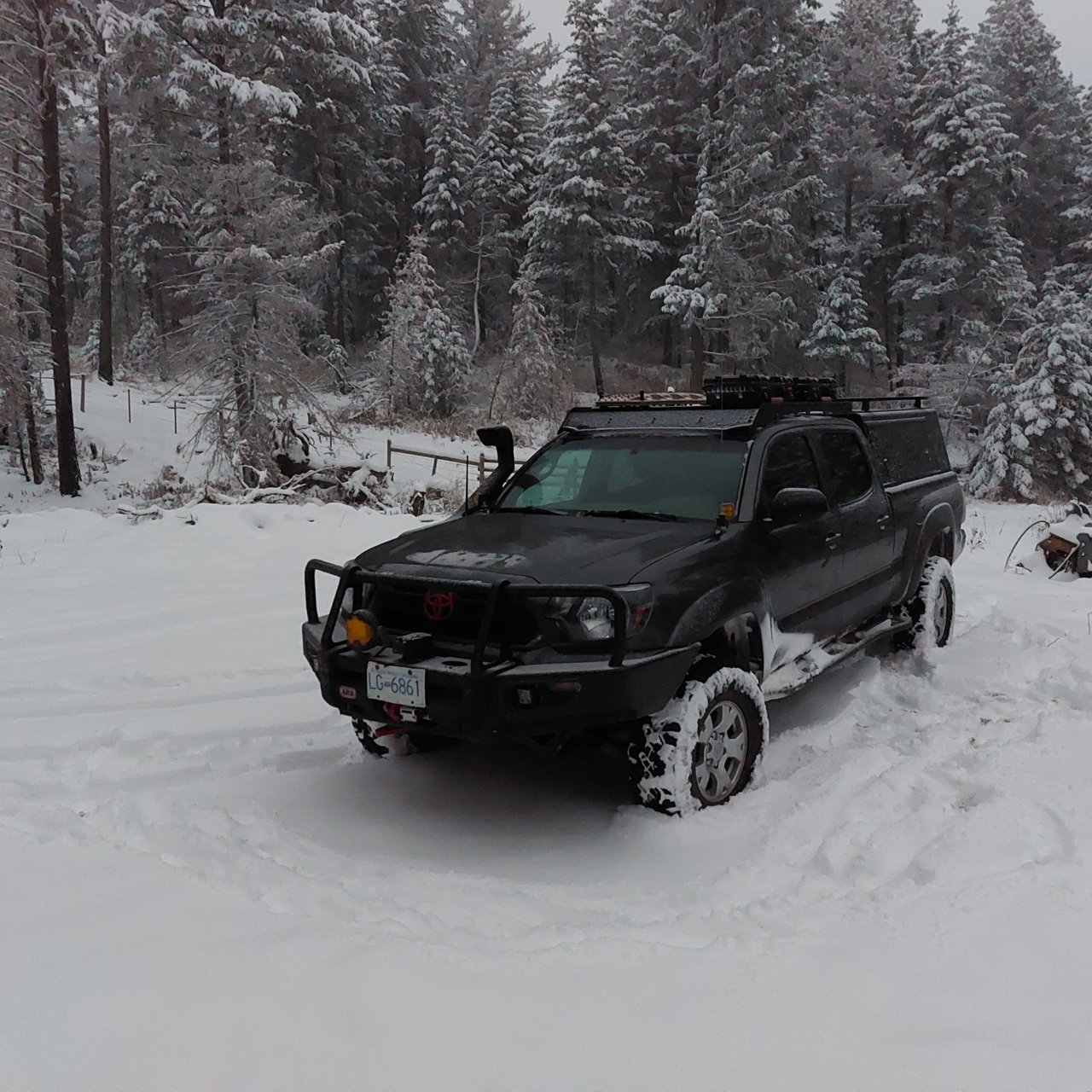

    I think it's a question of use - If I spent more of my winter time on bush roads than pavement I wouldn't hesitate to go with the LT versions, Toyo CT, Blizzak LT, even the Duratracs - these are made to chew snow and still do alright on pavement. I've never had a problem with the DM-V1 or V2 getting into or out of the snow spots I go, but sounds like you've already reached their limits offroad.
    I do though spend a lot of time on winter highways, compact iced streets, blowing drifted roads, and everything in between - the Blizzaks have performed flawlessly through 12 seasons of Tacoma driving..
    BC Hunter and hp415[QUOTED] like this.

  5. Nov 10, 2022 at 1:45 PM
    #345
    Dalegribble02
    Dalegribble02 Well-Known Member
    Apr 27, 2019
    #291535
    1,368
    Savona British Columbia
    2014 SR5 4x4 meg grey sold
    Dobinson mrrs Deaver leafs archive garage hammer hangers.
    Studded duratracs for me

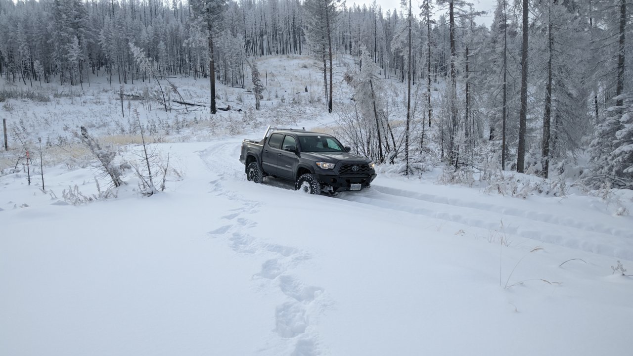

  12. Dec 18, 2022 at 10:53 AM
    #352
    couriersean
    couriersean Member
    Jan 2, 2022
    #386094
    8
    2020 Tacoma TRD off road
    General Grabber Arctic LT tire review:
    Bought these last winter for a 400+ mile trip (one way) with snow from door to door. These tires were studded and mounted on my stock wheels. They vibrate around 50mph and I assumed it was a poor balancing job of the shop, but I dealt with it for a thousand miles before swapping back to street tires. Vibration was gone with the street tires. Mounted the snow tires this winter on a new set of wheels at a different tire shop and the same vibration is there. Even with studs, I'd give these tires a 3/5 for snow/ice acceleration and stopping. I sometimes have to put it in 4wd to get rolling at intersections and forget quickly merging on the highway from a stop. That said, I'm not terribly impressed with the traction with the stock tires if it rains!
    For reference, I live in North Idaho, and we've had snow for the last 7 weeks, and I'm driving a 2020 TRD offroad, with 50 pounds of sand and a fiberglass canopy. I've dropped the PSI a couple pounds, but I might try a few more to see how it does. At this point, I'm considering punting the tires and going with a studless winter tire.

    Studded tires sometimes have studs pop out or wear in for an imbalance, we see lots come back after a month for a rebalance, and rarely have studless complaints. No big deal
    The LT tire is rough though, very hard tread, so the tire relies on weight and the studs to stop the truck.
    Tacomas struggle in the winter due to how light they are, and no lsd in the rear, so the step out on acceleration is fairly normal.
    I just drive in 4WD when its crap out.
    Good review, hopefully people consider it.

    The tires felt like they were out of balance when I left the shop on dry pavement with the brand-new tires. I drove them around on snow-free roads for roughly a thousand miles and they still vibrated. I kind of forgot about it until I put them on the new wheels last month and it's still there. No funny wear, and all the studs are looking great.
    Maybe I should've considered a lighter tire now that you mention it.
    I will say that the truck does great in 4wheel drive, with or without studs honestly, but I was aiming to avoid running in 4wd all the time.
