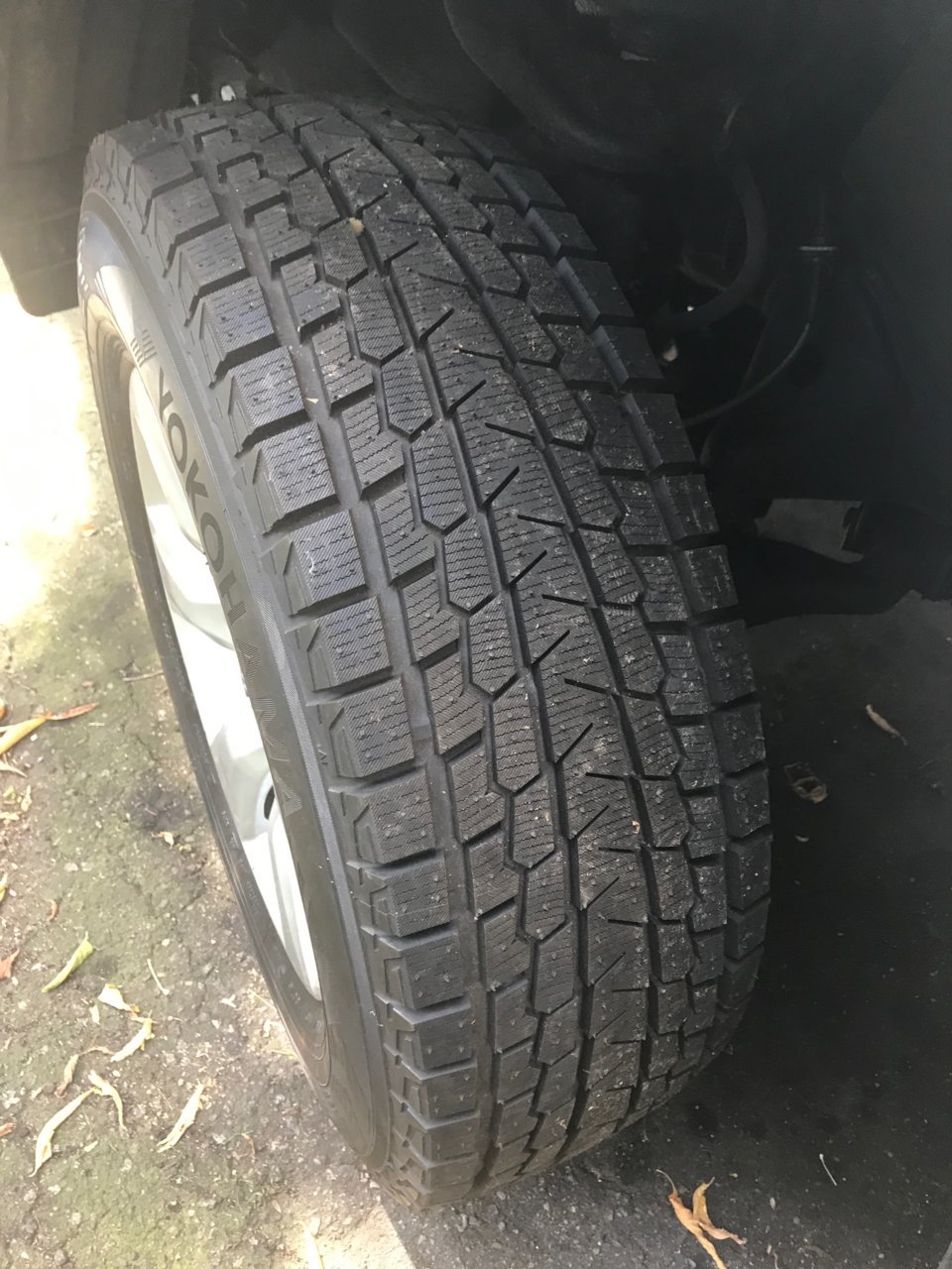

    And yes its early but being retired and will put on less than 200 miles till November 15th which is when the average temp is due to drop to around the recommended 7C point. I decided to swap over the new G075 snow today since i much prefer to do it when its warm and dry rather than cold and wet. One helpful additional step I do is to give the mounting points on the wheels a coat of anti seize. Make them just fall off the hubs when the wheel nuts are off rather than needing a little gentle persuasion.
    These are 245/70/17's vs my summers 265/65/17
