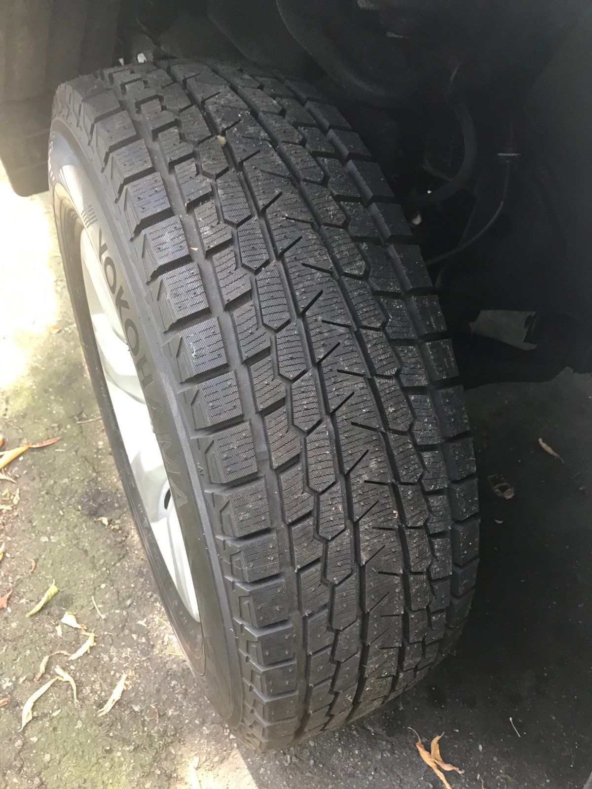

  2. Nov 5, 2023 at 8:14 AM
    #402
    babylon5
    babylon5 Well-Known Member
    Aug 19, 2015
    #162175
    925
    David
    2015 Tacoma Double Cab TRD Sport
    Exactly.. If you live in an area that never gets below 7C then lots of regular tires will do the job. The rubber in true winter tires is designed to stay flexible at temps well below 7C. And up here in Toronto or at the cottage it can get to -35C. Regular rubber is like a hockey puck at those temps and you know how well they stick to the ice. I never go off road. So in the summer run the bridgestone alenza plus.
    And winter my yokohama G075.
    Same here . I run a narrower tires in the winter 245 vs 265 . Better for traction and generally cheaper to.
    True again. A wide tire in snow behaves like a wide tire in rain. Instead of cutting thru the rain/snow it builds up in front of the tire and can cause a total lack of traction

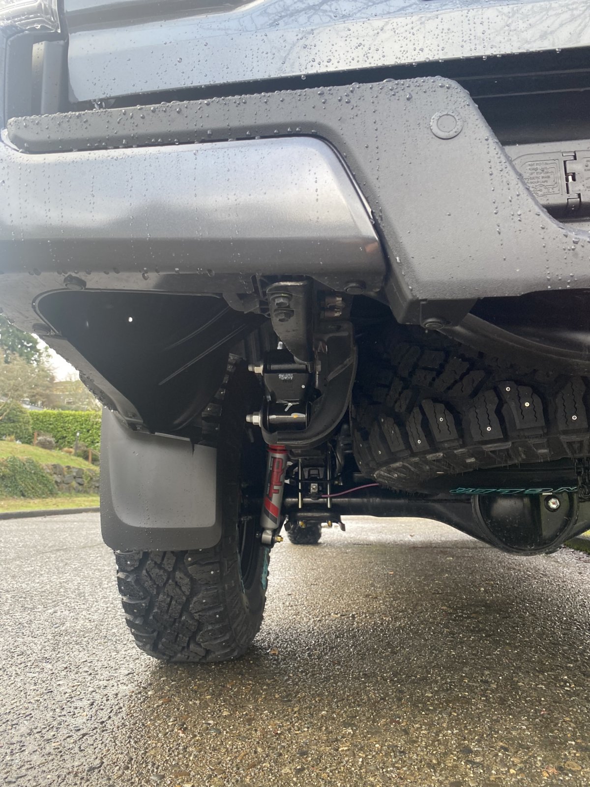

  3. Nov 5, 2023 at 8:33 AM
    #403
    AK Dudeman
    AK Dudeman Well-Known Member
    Jan 24, 2023
    #416259
    806
    DCBLB OR MGM 22
    265/75/16 Duratrac Studded & Sipped, works Awesome…

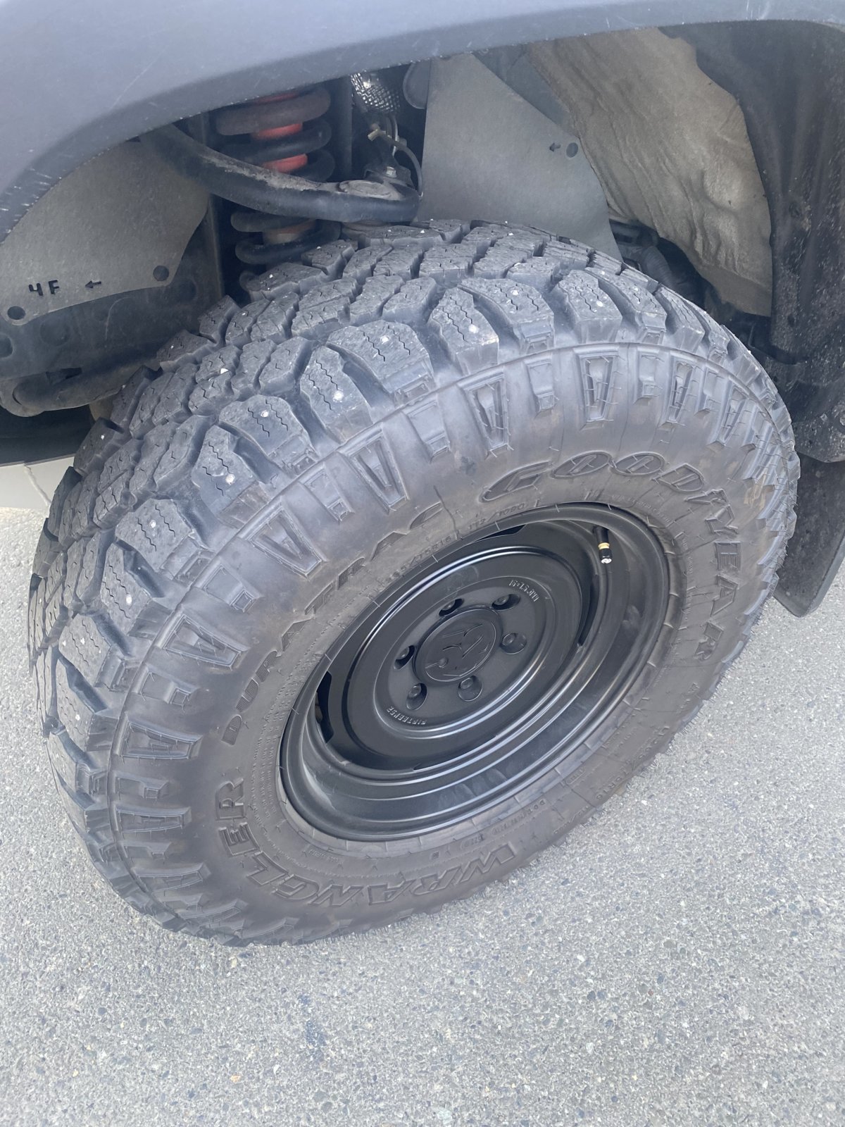

  4. Nov 5, 2023 at 8:47 AM
    #404
    AK Dudeman
    Jan 24, 2023
    #416259
    806
    DCBLB OR MGM 22
    & although that pic doesn't show it very well, on the main part of tire there are “scallops“ for lack of better word. There are designed to help get snow out from lugs, not let it get packed in there. Duratrac replaced the old Workhorse & lot of R&D went into them. Talked to main Goodyear guy when they first came out. My F350 has a set & I have summer set. Hell my spare is Studded to but that a different story.
  5. Nov 5, 2023 at 8:50 AM
    #405
    Bishop84
    Bishop84 Well-Known Member
    Dec 17, 2015
    #172494
    12,007
    The problem with duratrac studded is they are the E rated usually and you have to run fairly low pressure for the studs to make good use.
    I agree with duratracs for severe use especially off groomed roads, but for city ice they just arent great due to the hard carcass. I used to run duratracs as summers in western canada as a reference.
    BC Hunter likes this.

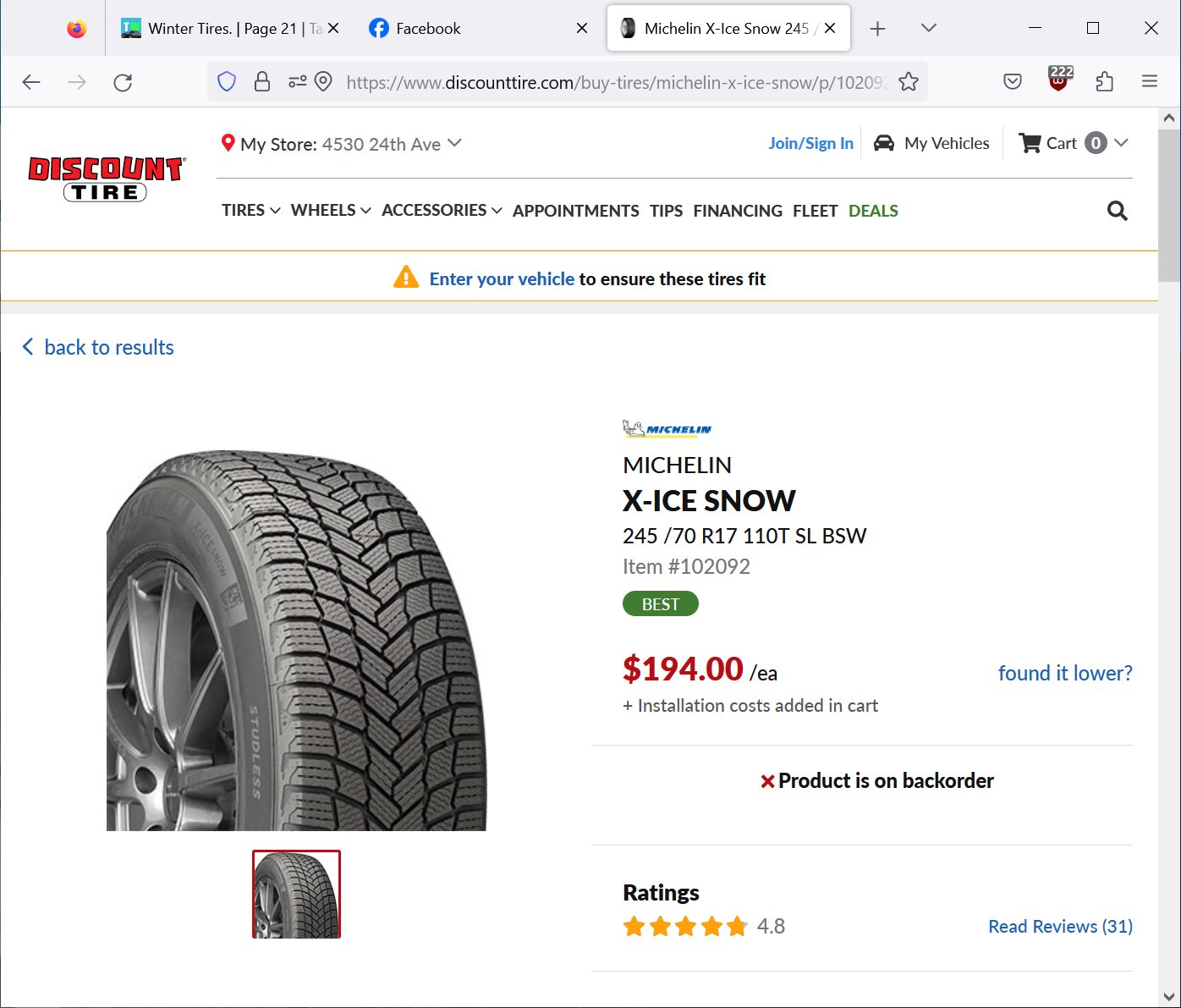

  11. Nov 20, 2023 at 1:27 PM
    #411
    2ski4life7
    2ski4life7 Well-Known Member
    Apr 30, 2012
    #77911
    2,207
    Seattle WA
    17 DCLB 4x4 TRD Off Road Previously '12 DCLB 4x4 SR5
    Any recommendations for a winter specific tire for 17" rim. Currently running cooper at3 4s 255/75r17 for winter/summer. Been fairly happy with them besides they wear pretty fast during summer. Looking to go winter/summer tire set now.
    Id be okay with a 255/75r17 size or should I go OEM size for cost savings?
  12. Nov 20, 2023 at 2:04 PM
    #412
    babylon5
    Aug 19, 2015
    #162175
    925
    David
    Going to be many choices but here are mine. Yokohama G075. 245/70R17 (same diameter as factory 265/65R17)
    Reason for choice. Last set lasted quite long for a snow tire. economical as far as snow tires go. Not at all noisy for a snow tire.
  13. Nov 20, 2023 at 2:18 PM
    #413
    babylon5
    Aug 19, 2015
    #162175
    925
    David
    Discount tire has these on a really good price... Its usually one of the more expensive ones. Surprised it was at the top when i sorted by price (low to high)
    Being retired I should have given more thought. to how much i drive (4000 miles a year) before I got the Yokohama's...Excellent tires, nothing wrong with them but even my last set had 40% tread left at 8 years and I was commuting. These will have even more now.. If i could go back i would have gotten the blizzak's
    Discount Tire and 2ski4life7 like this.
