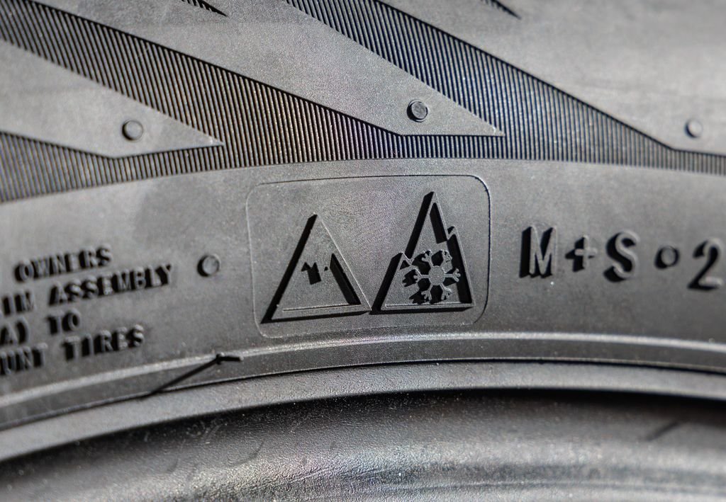

    In most test i have seen (tirerack etc) its done on an indoor ice rink. Any faster and they wont be able to get up to speed and brake in the distance available. And speed is Irrelevant in this test. If it can stop 18%+ better at 15 it will do the same at higher speed.

    18% or shorter braking distance from 12-15 mph than reference tire. Its all there

    Excellent. Seems nokian was the first to include this new certification. Sure others will follow soon. They probably already meet it but just haven't done the required test yet.

    Its like the snowflake symbol where anything 10% or more gets it .For this new test anything over 18% better gets it. I agree that it would be nice if it was rated the same as treadwear where the number get larger based on comparison to a reference tire.
    One is just acceleration on medium packed snow. The other braking on ice. Totally separate tests. One is more dependent on tread pattern, the other tread compound and sipping. Thus you can have one tire better than another in acceleration and the another better in ice braking. Better in one doesn't equal better in the other.
    And from basic high school physics the coefficient of sliding/kinetic friction is not dependent on speed. So if its 18% at 15 mph its 18% at 60 assuming the surface is the same and its much easier to maintain the same surface in an ice rink than a lake.
    "The coefficient of kinetic friction does not change depending on the relative speed of the two objects. The coefficient of kinetic friction depends only on the types of surfaces in contact."
