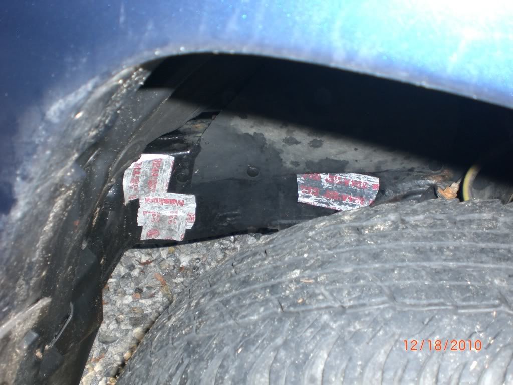

    Dont have pics (too lazy) but cover the holes that are on the front of the frame right next to the front wheels. I used aluminium self adhesive tape (additional rust protection) to cover them up. Tape can be purchased at your local hardware store and its used to cover the duct work or furnace exhaust work.
    Last winter I realized front tires are pushing snow with salt inside the frame, thus speeding the rusting that nobody can see. So I cover those holes for this winter and spot check revealed that, so far, the inside of the frame is dry.

    I considered that for a second but Its the boxed frame part. If you do that it will make frame too ridgit and it may crack, plus foam will trap moisture and probably just make it rust faster. It needs air flow from the engine to keep drying up. So holes on the inside (towards the engine) are left alone only holes that are behind the wheels covered. Before the cover up it was packing snow inside and rusting. this year I painted the inside so I wanted to protect it even more.
    Honestly I dont even know why Toyota had made holes there.

    No problem, tape is good for now and when i have a time I will just tack weld some steel vent/splash covers, so air can get through but it will shield from water/snow/salt. I painted inside the frame so I did not want to get too much of water in there before I cover up. I did painting late and I was out of CO2 for welding so I figure out I just do something ultra simple there for winter
    My guess is holes are used during manufacturing process to hold the frame in place. They are square, oval and round so all kind of things.

    Is there another way for brine water that gets into the box frame to drain out? If that's the only hole for that I'd be a little worried about plugging it.
    I'm not really sure what you're talking about though!

    Ah you guys made me go take a picture .. :D I updated first post with a snapshot of wheel well. You can see tape, its not fancy solution but should hold through the winter. Holes are directly where they should not be, Theree are more holes at the front and on the inside but those does not seem to be a problem and I left them open for venting. Once that I taped are source of water and salt throughout a winter. Most of the water drains down but thanks to that mis-design new water is send inside every time we drive.

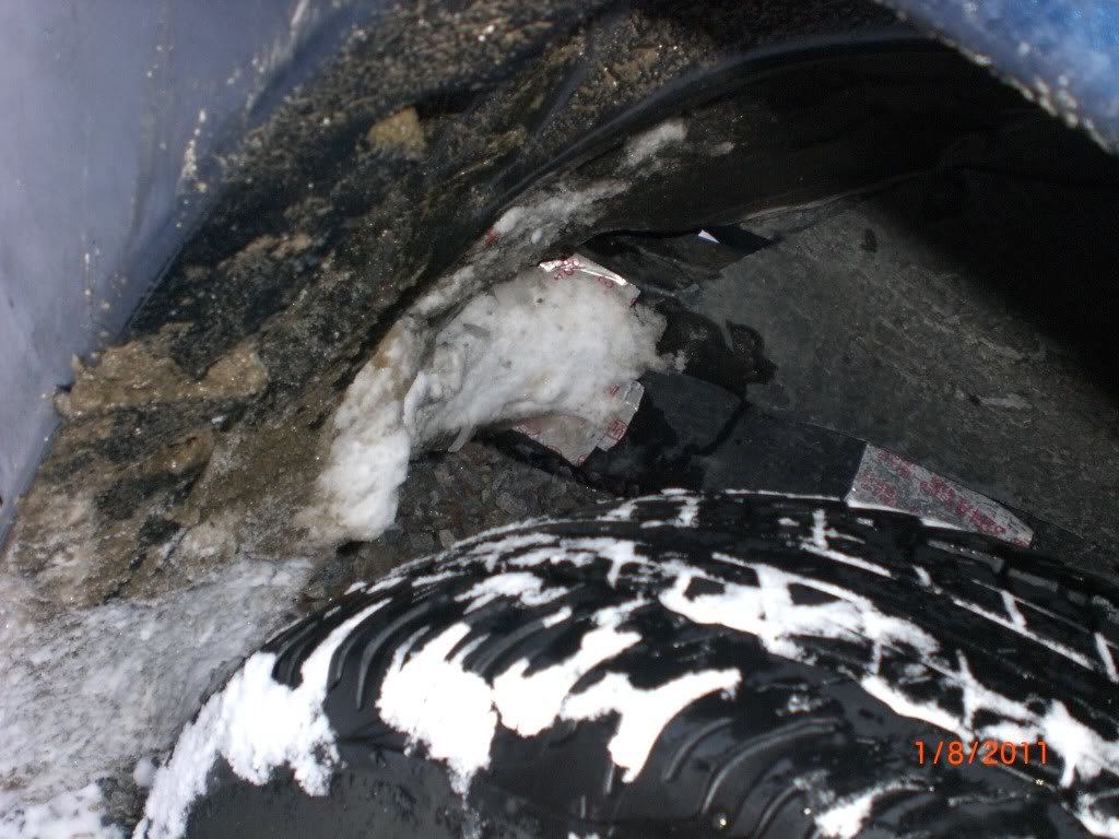

    Update with picture. So winter is here and I got chance to take a photo showing where snow collects on underside of the truck. As you can see if the hole in frame was not covered there would be bunch of snow with salt inside of frame.

    There ya go ! Proof is in the pudding (pic). Great Idea:D
