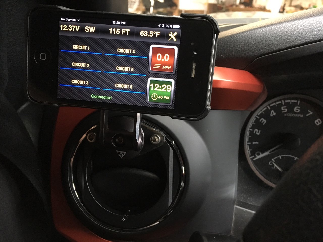

    I highly recommend this product:
    https://www.neutrinoblackbox.com/
    I have one in my Tacoma and one on my motorcycle. It consists of a small “blackbox” with 12V input and 6 controllable outputs, all protected by electronic (self-resetting) circuit breakers and programmable to be either switched on/off or varied from 0-12V. Outputs can also be programmed to go on or off or even adjusted based on time or temperature. The unit is about the size of a deck of cards and the controller is a smartphone via Bluetooth. Designed and assembled in the US. Screenshot of my Taco install below. I use it with an iPhone but it supports Android also. One cool feature for older trucks (or bikes like my DR650) that have limited OEM instrumentation, is that it in addition to circuit control and monitoring, it measures ambient temperature and battery voltage, and displays that plus data from the phone including location and heading from the phone GPS. So you can always see ambient temp, battery voltage, altitude, heading, time of day, and speed. The battery voltage monitor can be set to automatically shut down all outputs below a selectable threshold.

    That’s really slick. Do you have a dedicated phone for it?

    No, that’s just my regular phone. It’s mounted with a Topeak bicycle phone mount that clips on and off. The Topeak Mount is attached to a Hondo Garage UnHoley Mount. Full disclosure, I am a longtime friend of the developer of the Neutrino, but it’s been on the market for several years targeting the motorcycle and Polaris Slingshot community; he sells direct but also through many retailers. Here’s a review, note that it starts out talking about a previous generation product from the same company which was larger and used a dedicated wireless RF controller panel, then it segues into the current model with smartphone interface.
