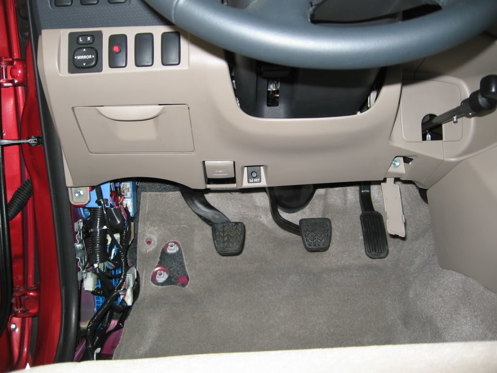

    007Tacoma
    007Tacoma I dub thee malicious!
    Jan 4, 2007
    #643
    6,645
    Mark
    San Antonio, TX
    2015 4Runner Trail Edition Premium
    Cloaking Device
    I have the Gulf States Toyota "Upgraded Alarm System". It came new on my truck. The below picture is from my DRL OEM Upgrade Thread. It shows the LED Switch on the left side of the steering wheel.
    Curiousity has it: I don't have the "chirp" like other Tacomas, but I have a "horn chirp" that is 1-to-lock/arm and 2-to-unlock/disarm. Anybody know about this? I have lost the paperwork on my alarm system, so I am at a loss...

  14. Jul 20, 2007 at 9:19 AM
    stratton
    stratton Well-Known Member
    Jul 2, 2007
    #1977
    329
