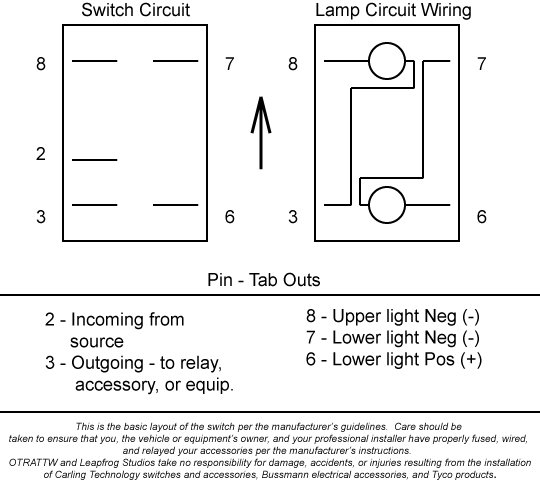

    Howdy wiring and 'lectrical type people.....especially Proforce, Rich91710...
    Here is your challenge.....
    Instruct me on how to wire my 3 Kragen HID lights, safely.
    I have almost no skill or technical ability. I can use hand tools. I have a circuit tester ( i think....one black prong, one red). I know to take off the neg battery terminal first....but then I am kinda lost. I can't read a wiring diagram....but I sorta can follow the logic of one.
    Anyway,
    I will post pics of what I have soon....
    I have the 3 HID lights and I have a OTRATTW switch.
    I have some 18 ga. speaker wire around.
    Pics tonight....
    Also, to the winner(s) I will make a gift of $10 to the paypal addy of your choice.
    This isnt really a contest, but more like a way to pay the knowledgable contributors back for all they have imparted to me.
    Pics to follow.
    Also, someone give a shout out to the guy from puerto rico that is an electrical genius too. I forgot his name.

    Ballast and the light units should be pretty straightforward plug-and play out of the box.
    The issue is safety connecting the mess to the truck.
    The OTRATTW switch is a nice unit and wiring is pretty straightforward.
    Pins 6 and 7 both go to chassis ground. One (7) is the ground for the background illumination, and the other (6) is for the indicator light.
    Pin 8 is the supply for the background illumination. You CAN tap that into the dash wiring, but it's a bit of a PITA and if you never dim your instrument dimmer, you can just wire it straight to a switched power source.
    Okay... Assuming that you are not wanting to run the lights any time and want them to shut off with the ignition (safest way to go, wired hot 24/7 you WILL eventually come out in the morning to a dead battery).
    You need to find a switched hot on the underdash fuse box. The radio and ciggy lighter are common sources.
    Remove the factory fuse, and replace it with an Add-A-Circuit.
    Before installing, turn the key on, and using a voltmeter or non-battery powered test light, connect the black to a good chassis connection and using the red, check both sides of there the fuse came out. One will have power, one will not.
    Insert the original fuse into the terminals on the Add-a-circuit closest to the legs, and insert it into the fuse block with the pigtail wire OPPOSITE where you probed the power source.
    You should now have power going to your radio or cig lighter.
    Install a 5a fuse in the other space on the Add-a-circuit.
    Run one of your 18ga wires from the pigtail to terminal #2 on the switch. You can also jumper it to terminal 8. This will have the switch illumination on any time the key is on, but it is the simplest way to do it.
    Now, run your 18ga wire from pin 3 on the switch out the firewall and to pin 85 of a regular "cube" fog light relay.
    Connect pin 86 to ground.
    Turn the ignition on and have someone operate the switch while you rest your hand on the relay and listen to it. You should hear it open and close the contacts as they flip the switch.
    Run pin 87 on the relay to the hot supply wire of your light ballasts. You're going to want to use something heavier than 18ga for this. I'd go with 12.
    Now going the other way, run pin 30 on the relay to an inline fuse. This fuse is going to protect the wiring going to the ballasts, so it (and the wire) need to be large enough to supply them. 12ga wire can handle 23 amps enclosed, so I would run a 20a fuse. That can supply 240 watts peak and 192 watts continuous... I would imagine that your driving lights are 55 watts each, so with 2 of them you have plenty of overhead for the power spike at startup.
    The fuse needs to be connected to a solid power source that is hot 24/7. Directly to the battery is a good place, but most underhood power blocks have screw terminals accessible where the battery cable attaches and you can usually find a matching nut and simply attach the wire there using a ring lug.
    That should do the job.

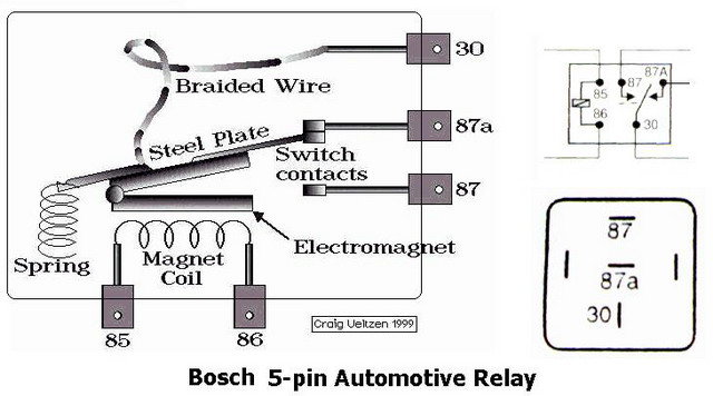

    OK, the directions Rich gave are perfect. I personally would do it slightly different and a little easier IMO, but either option will work great. Here is the small problem though, you said you have (3) Kragen lights right? Well 1 relay can power 2, but may have trouble powering the third. Its going to be pretty risky putting 3 lights on 1 relay so what Im going to do is put 2 lights on (1) relay and the third light on a second relay.
    This first diagram is all the wiring that is going to take place inside the engine compartment. You will need 2 standard 5pin automotive relays, connectors, wire, and EDIT: 2 inline fuse holders; one with a 20amp fuse and the other with a 10amp fuse. This may look like a disaster, but ill explain everything:
    So, the 2 relays you have each have 5 pins labeled 86, 85, 30, 87, 87A.
    On both relays, pins 87A are not going to be used, just leave them as is.
    Pins 87 are your output of the relay when its turned on so these will go to the positive wire of your lights (usually red, or whatever other color wire is there besides black.. black should be the (-) ground wire on each light). Your going to attach 2 of the lights to 1 relay and the third light on its own relay as shown. The size of the wire used should be equivalent or greater than the size wire thats already coming of the lights.
    Now your power for your lights and to power the relays. This will be pins 30 and 86. 30 is what will directly power your lights through the relay, so this need to be a good size wire. I would recommend 12 guage wire for pins 30 to the battery.
    **NOTE: I messed up the drawing by showing both pin 30's connected to each other, then going to the battery with a single fuse... this will work, but is not ideal. Each relay should connect to the battery with its own separate 12g wire wire AND its own separate fuse. The relay powering 2 lights needs a 20amp fuse and the relay with only 1 light needs a 10amp fuse.**
    For pins 86, these also need power. You can jump pins 86 over to pins 20 to steal power from them. You can use a small wire for this, as pins 86 only need 200ma draw which is nothing.
    Pins 85 is whats going to trigger the relays from your switch. These are going to be (- ground) trigger wires. That way, you can skip the entire part about tapping into the fuse box in your car and using the add-a-circuit thing. It just simplifies the process.
    *Just for the sake of explaining how and why, this is a relay:
    Pin 85 and 86 are connected to a magnetic coil that triggers the relay. At rest, pin 30 is connected to 87a at all times. When 85 and 86 get power and ground, then 30 switches over to pin 87. Hopefully that makes sense. So what Rich did was have your relay connected to ground at all times (pin 85), then use the switch to send 12v to pin 86 to trigger the relay. This requires that your switch have power, so I made it so that your relay pin 86 is always powered, and your switch sends ground to trigger. Its the exact opposite, but doing this avoids having to power your switch and find a fuse to tap into.*
    (I WILL FINISH THE OTHER DIAGRAM FOR YOUR SWITCH WIRING TO COMPLETE THIS AND POST IN A LITTLE WHILE - HOPE THIS HELPS GET YOU STARTED)

    That diagram will work fine for a standard switch, but he's running the illuminated switches.
    The nighttime illumination light can be powered by an external source so that's not a problem, but the indicator light taps into the switched output and goes to ground.
    Running ground-true switching would have a small current flowing through the light 24/7, and it would go dark when it turned the switch on (ground applied to both lights).
    The switch is internally wired... I don't think there's a good way to provide the indicator light using ground-true switching.

    Actually I don't.... I was sent a pdf of the switch and went from that, but the pdf did not have the internal wiring, and it indicated the wiring as I had related.
    Maybe they modified it and one of us has an old drawing?

    Odd... They do show a few different wiring patterns for various switches, but it looks like the one you posted is current.
    Going to email the guy who sent me the pdf and clarify.

    Easy enough to verify.
    Apply power to 3 and a ground to 8 and see if the indicator light comes on.
    Then apply power to 6 and ground to 7 and see if the switch illumination comes on.
    If they do, then follow Pro's final diagram (but use 10ga wire instead of 12 with that 35a fuse ;) )
    If not, then try power to 8 and ground to 7. If the illumination comes on, then move to 3 and 6... if the indicator works, then use Pro's but modify the switch connections to match my description.
    The issue is the switch illumination. In any case, pin 2 gets power from the add-a-circuit, and pin 3 sends power to the relay (and to the indicator light).
    You just need to find the ground for the indicator light (it's going to be either 6, 7, or 8, and you won't blow anything up by applying ground to each in turn to test), and once that is identified, the remaining two pins can be wired to your dash lighting.
  18. Jun 23, 2012 at 6:18 PM

    Anthony, your diagram is the same as the one I got from OTRATTW.
    Rich, i can easily scan and send the OTRATTW diagram from the switch to you on Tuesday when I get back to work, just PM me a good email and it'll arrive as a pdf.
  19. Jun 23, 2012 at 6:26 PM
    #19
    Rich91710
    Rich91710 Well-Known Member
    Feb 23, 2012
    #73470
    16,341
    Rich
    Los Angeles
    08 Base
    Satoshi with FJ badge, factory cruise, factory intermittent wipers, Redline Tuning hood-lift struts, Hellwig Swaybar, Rosen DVD-Nav
    I found Anthony's diagram on their site.
    Still haven't heard back from the guy I was exchanging emails with, but I did send him a followup to double check his switch to make sure it's correct.
