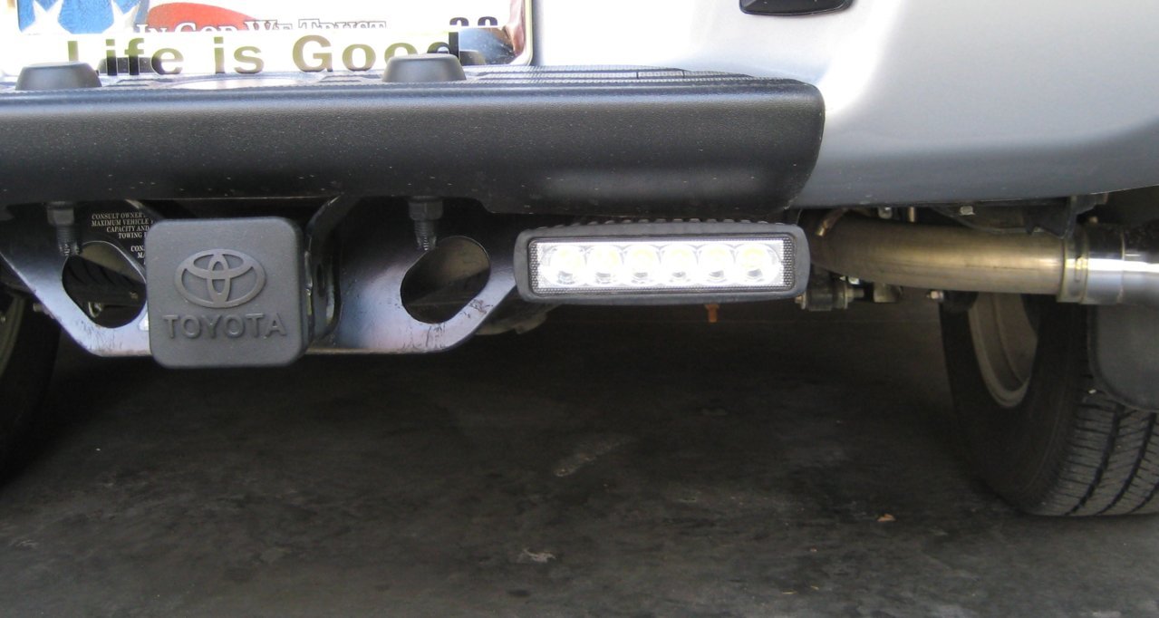

    What about tapping a single 9 watt LED rock light tapped of of the reverse lamp wire?
    Doesn't sound like enough current to worry about.

    Installed 6 years ago, tapped into right side reverse light - w stock bulbs. 18w - pulls 1.5 amps.

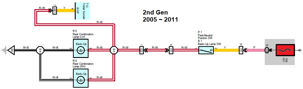

    Will work fine. My HIR reverse upgrade goes from 18w->35w without issue, but the 10A circuit is also used for the tow harness, so whatever you add in reverse draw subtracts from what you have available to a trailer in towing.

    Not the same for a 2006. 2011 on to 2015 is a signal input to Tow BU relay. Tow BU has own 10A fuse.

    2007 does not have a separate fuse for BU in Tow & pin, it shares the same fuse mentioned -10A IG1.

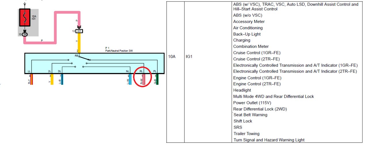

    For the Tow 7 pin, you have a fuse & relay for the Tow TAIL circuit; A fuse & relay for battery charging; Left & Right Turn circuit is combined with the Stop circuit via the Towing Converter (inside the cab), converter has it's own 30A fuse; and the Towing Brake circuit which requires a module; and ground.
    A few things to check to find the problem...wires, fuses...
    But in your Tacoma the BU circuit is a shared with the tow BU.

    This list seems ... Not plausible, are you sure this 10A isn't just for the indicator lights for all these functions? Or this is a list of things that each have their own 10 amp circuit? Because the 115v outlet being on there, you would blow it any time you did anything while using that

    Where do you come up with the statement?
    The list shows the circuit (not all of it) that the fuse has a relation to.

    So if I plug in surge strip and blow the fuse on the 115v outlet in the bed, I won't be able to turn on my headlights, taillights, AC, shift into any gear etc?
