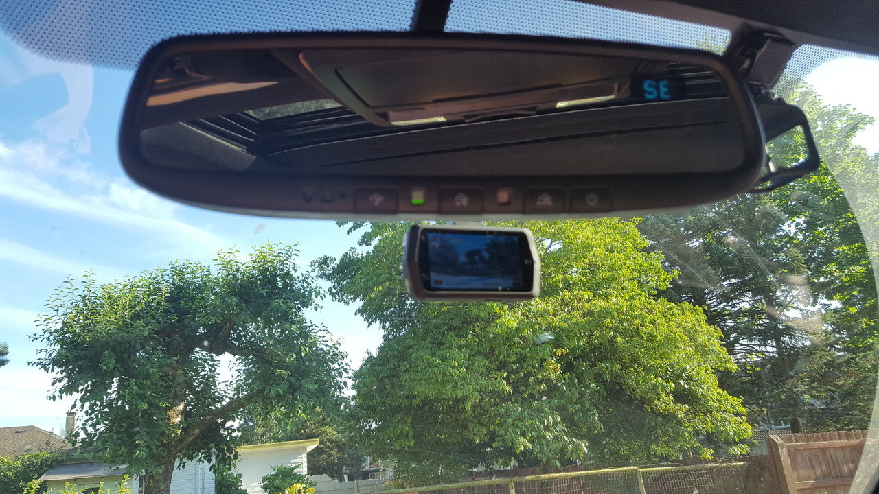

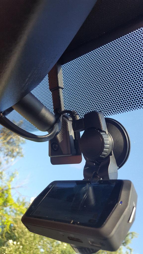

    Install complete. Tied into the rearview mirror wires as posted above. Blue for accessory and white/black for ground.
    Actually had my landlord confirm everything, I asked to borrow his multimeter and he basically did the install for me. Now I just need to convince him to get a Tacoma!
    Everything is working perfectly, really glad I've got this "mod" done and it's very seamless. I hardly know the camera is there now since I can barely see it while sitting in the drivers/passenger/rear seats. Its also mounted BEHIND the rearview mirror, so other drivers won't notice it very easily.
    What do you guys think? Hope this helps others planning on hardwiring their camera.
    I didn't want to hardwire to the battery since I didn't want to risk it dying if we go on vacation, and didn't want the complication of wiring in a switch just for a simple dashcam
