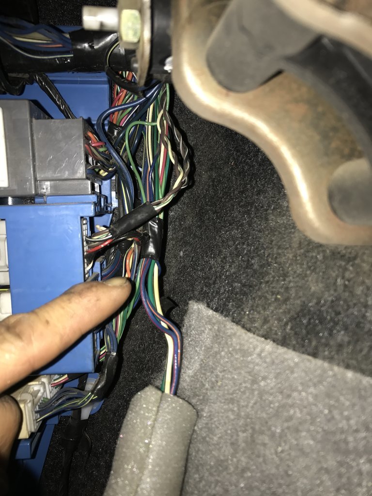

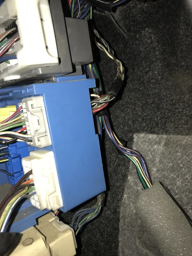

    I finally found the 4p plug. It was jammed between the blue plastic box with wires coming out and the firewall. Left side.

    IMG_1748.jpg IMG_1749.jpg A picture is worth a thousand words. This is after I have connected and wrapped the plug with the foam pad.
