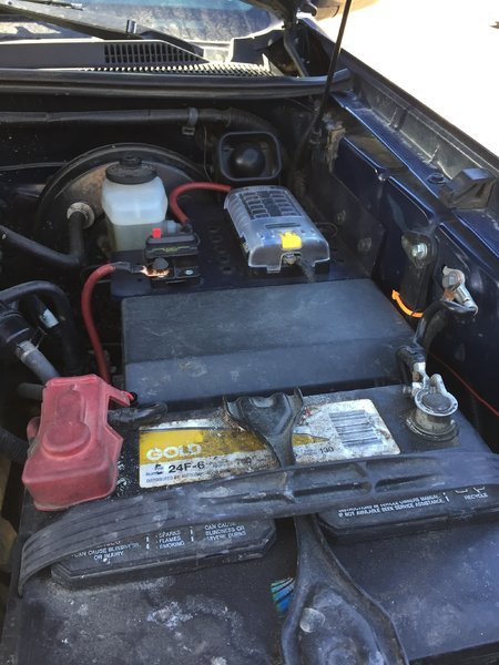

    Haha it's just dirty
    It's not brand new like yours:rolleyes:

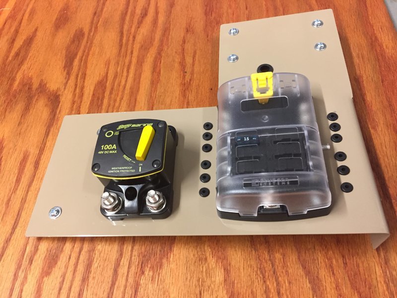

    IMG_2761.jpg I've got mine installed but need the weather to cooperate for final pictures. Made my own with some sheet metal from Home Depot, a rattle can, some drill bits and grommets from Lowe's. The rest of the hardware came from Amazon or eBay.
    The random screws are to mount my relays on the underside.

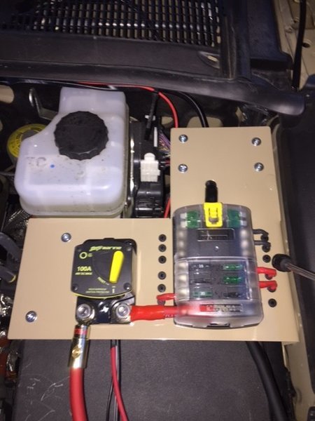

    Drivers side, two open threaded holes next to factory fuse block but not covering. I will have pictures tomorrow of it mounted with three spots filled.

    The wires under the plate are from my compressor that run too big of fuse for the fuse block.
