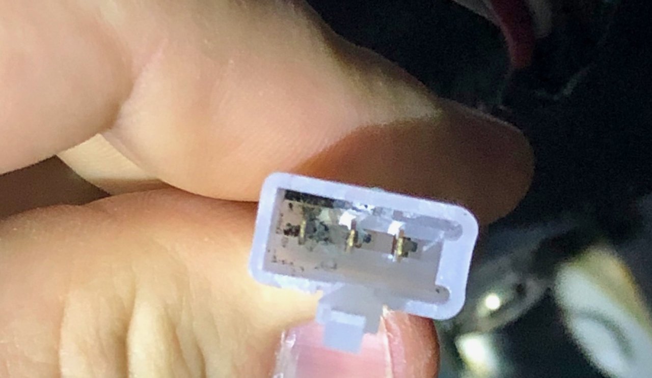

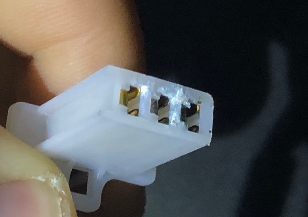

    Reporting back on the harness being used in a wet climate(Washington State), Ive got some corrosion on the plastic connection inside the engine bay. I thought I blew a fuse or maybe needed a new relay. but after some head scratching I found the issue.IMG_7748 2.jpg IMG_7751.jpgIMG_7750.jpg Heads up for anyone thinking about using the harness or having an issue. Im gonna grab some dielectric grease and see if the problem comes back.

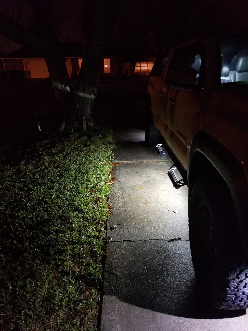

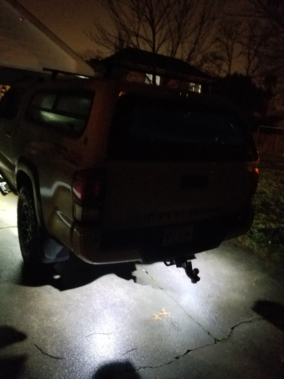

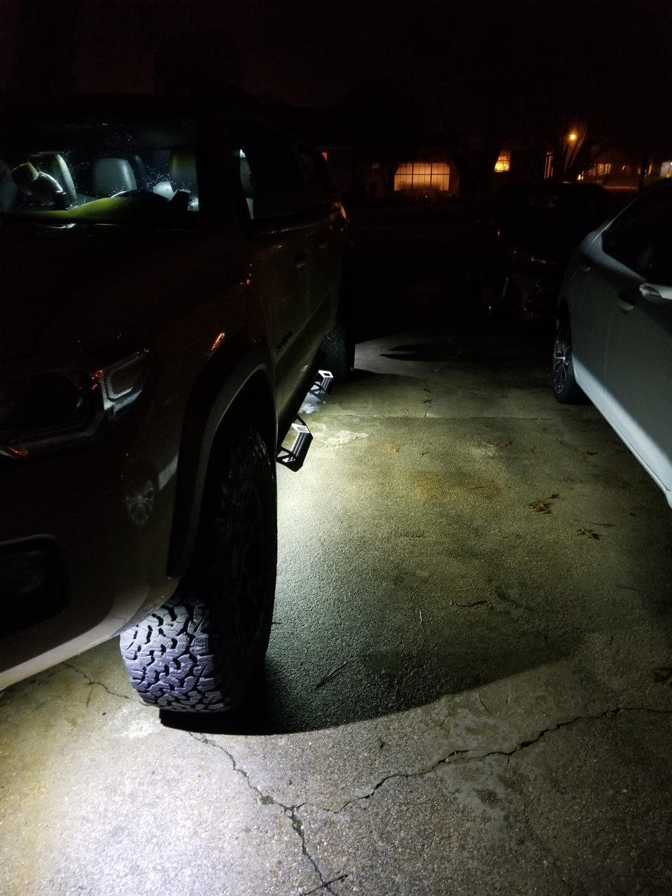

    Great walkthrough. Made my rock light install easy. Had to drill through the predator steps middle connection to push the led strip thru. Works great with the new dsim module.

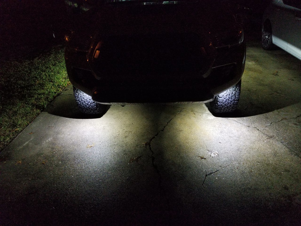

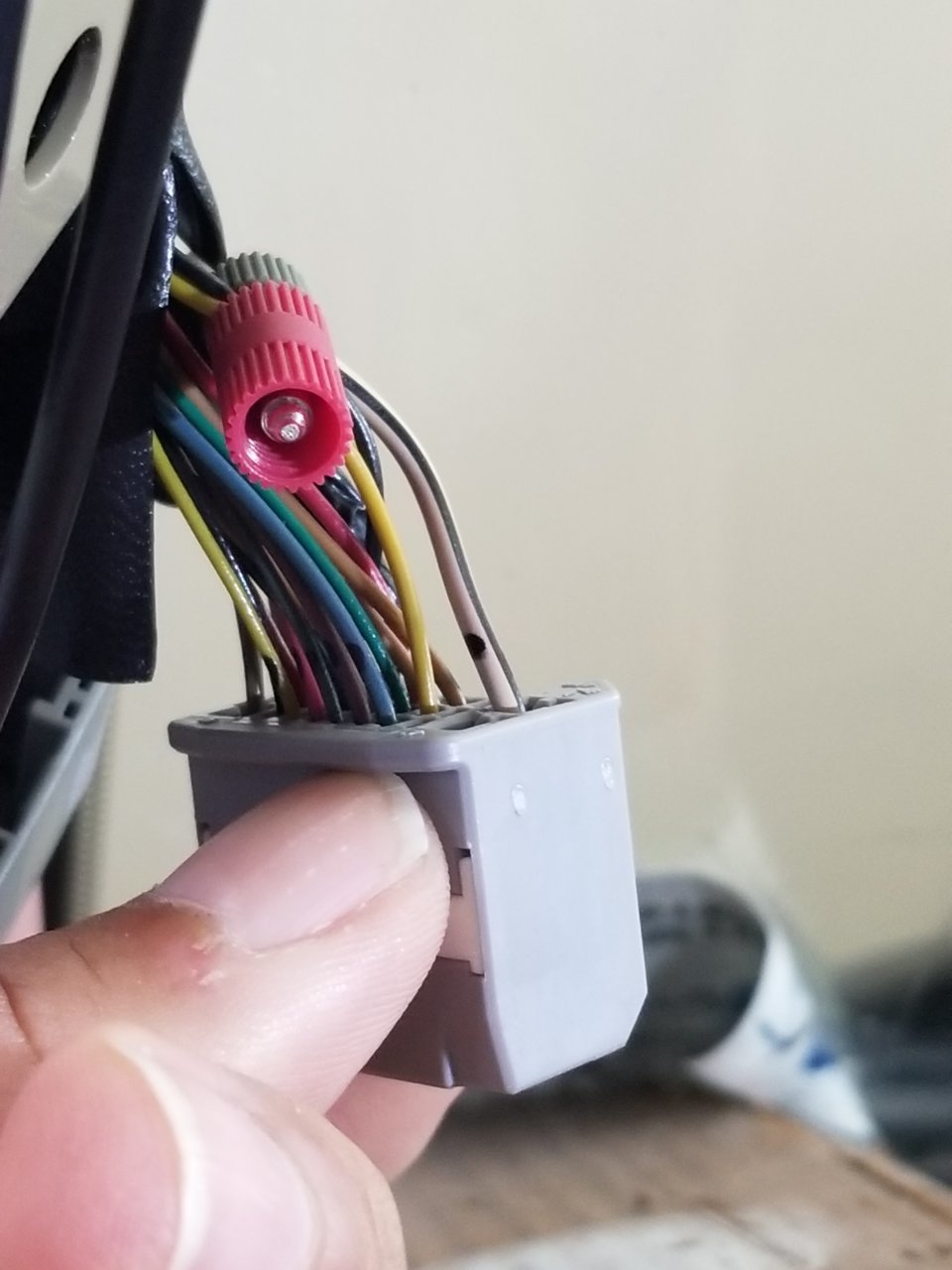

    Thanks for the rock light guide and wiring diagram! It was a huge help. As a side note for the DSIM harness the yellow wire to tap off the a pillar dome light harness is in the picture below. I had two yellows in my dome light harness and had to trial and error it.

    My V1 version of the DSIM harness is installed the same way as I had it before I installed the MESO harness. The black wire from the DSIM harness is tapped into the OEM a-pillar harness' dome light yellow wire with a quick splice connector.

    Disconnecting the OEM harness, you can see the DSIM black wire connected to the a-pillar yellow wire with the red quick splice connector
    Inserting MESO's T-harness, DSIM's wire is still the black one connecting to the upper portion of the OEM harness

    Have you had any more issues with this connector? Do you know the purpose of this connector? I'm thinking of cutting this connector out and soldering the wires together instead. Just wondering if there's a purpose for this connector I'm not thinking of.

    I have not had any more issues everything is still working great
