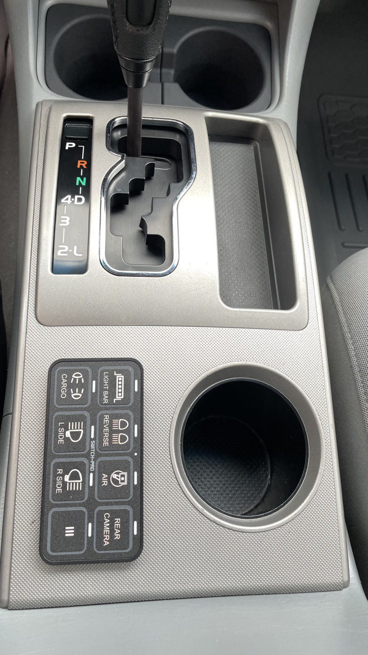

    Very nice install. I just moved my SP . I made a custom bracket and it was nice but found myself reaching a little. So i now have it in the shifter console. Maybe someone can help me or better explain how the switches work with the SPST turned on . I can’t grasp how it works if you only have one “load or device “ on one terminal. I know you can keep pushing the button to switch the source but still only have one wire as a output. Im trying to add a front camera and would like to use only one button. Any input would be appreciated thanks CF09AD5B-8308-44D6-9389-E2F827FA54F7.jpg07DFCCF0-7183-411D-8F73-1182ECFF08C8.jpg
