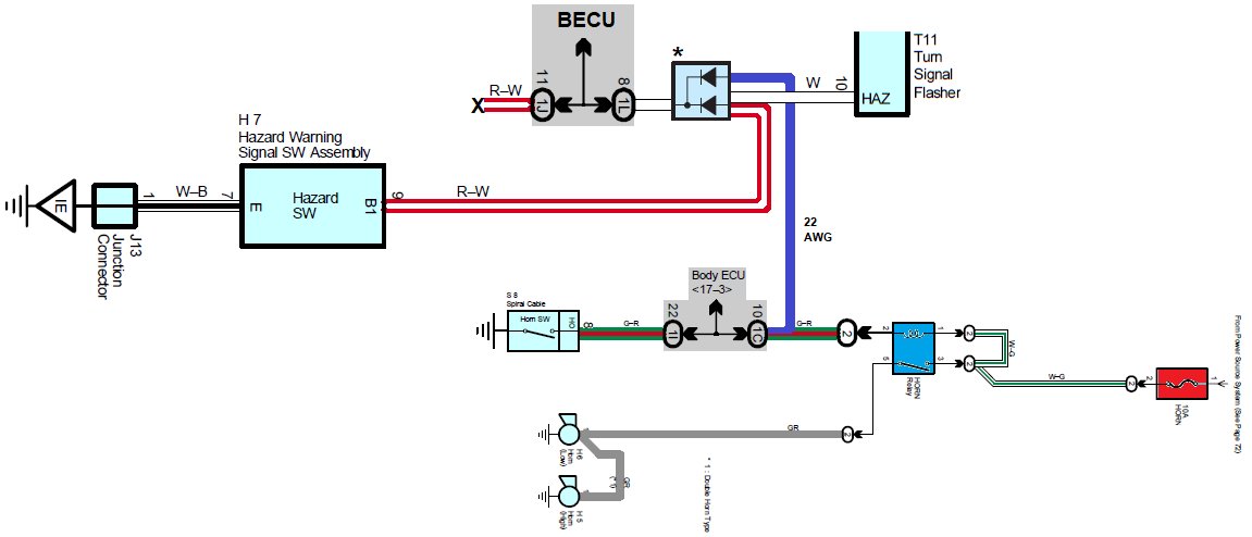

    ....is there any way to hook up a wire to the horn (that sends the signal to the parking lights) when I arm or disarm my truck? Or do I have to get an alarm system?

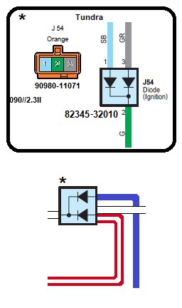

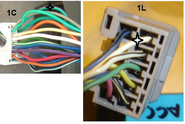

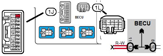

    #51121

    So you are wanting to make noise when you lock/unlock? ( I take it you have remote locks but no alarm)

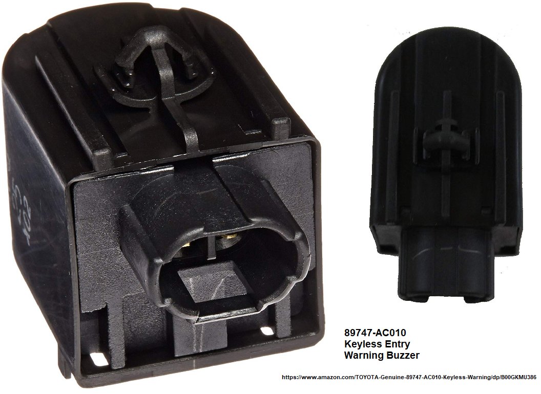

    You could also "add" the unlock/lock buzzard instead of the horn...

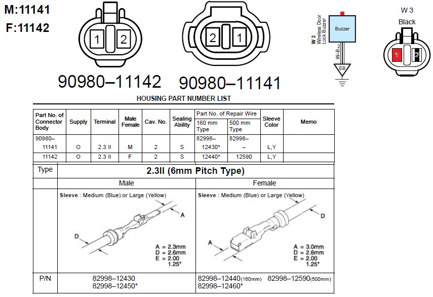

    If you have factory keyless lock/unlock there should be a connector on the driver side of the radiator support that the buzzer will plug into. My truck has the plug but doesn't have keyless entry.

    Pic the plug and post it, so he may see:bikewheelie2:

    This one is for the HORN.
    You de-pin (or cut n tape) the red with white runner wire (Hazard Switch) on connector 1J_11.
    Its terminal gets cut and crimped joining with a new white wire and female terminal (090/2.3II) to be inserted into the 3 way connector for the diodes.
    The other side of this new wire gets a female terminal to be inserted on connector T12 (Signal Relay).
    The original white wire gets reused, from diode connector to connector 1L_8 (de-pinned from T12, female)
    A new wire (20 awg size) gets t-tap (or how ever you like) to connector 1C_10 with other end crimped with a female terminal (090/2.3II) inserted into diode connector)
    When unlock is pressed on FOB, ground for HORN is made by BECU via Haz, like OEM. The diodes are there to prevent actuation of HORN when Haz are selected. Steering wheel horn works as before.
